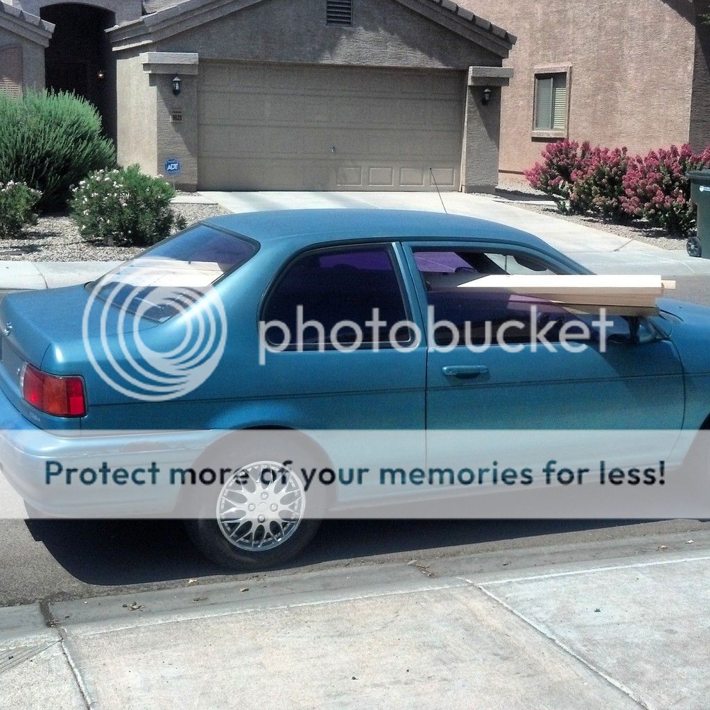

this is when my dad had the car.
found some daisy rims at the junkyard and decided to pick them up and paint them.

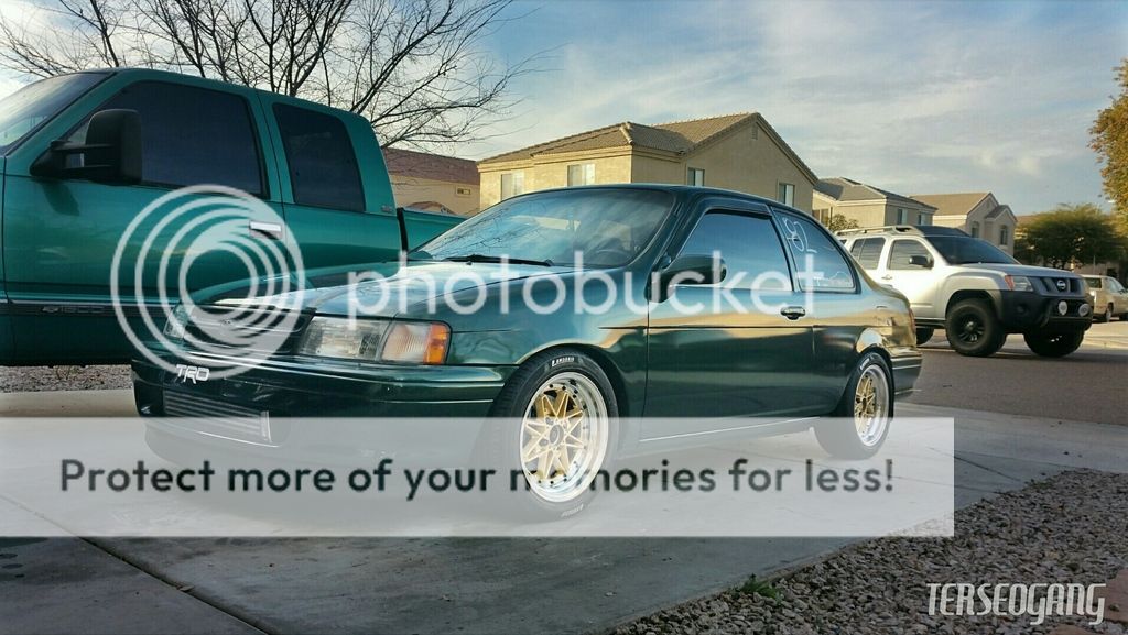

after some time with the car i began gathering more things for it. swapped in the DX headlights, paseo sway bar, paseo front and rear seats as well and some rota flashbacks.
Also dropped the car with new KYB schocks and B&G springs 1.6' drop all around.
FORWARD A COUPLE MONTHS LATER...:bananamac:

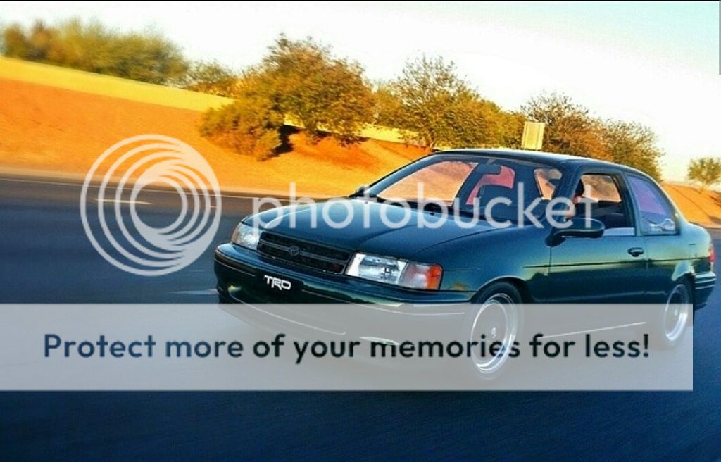

had the car get painted as well, Imperial Jade Mica from an Mk4 supra :naughty::thumbup:

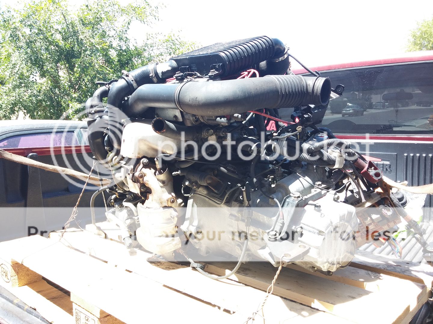

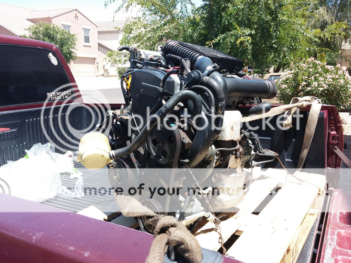

Also went ahead and ordered the 4efte from ebay from a seller located in canada.
Engine came with everything needed for a complete swap. also came with some goodies that i was sooo lukcy to have gotten.

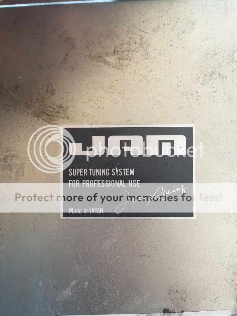

engine came with TRD spark plug wires and also a JAM racing ECU, and im sure you all know what it does.:bananarock::2thumbsup:

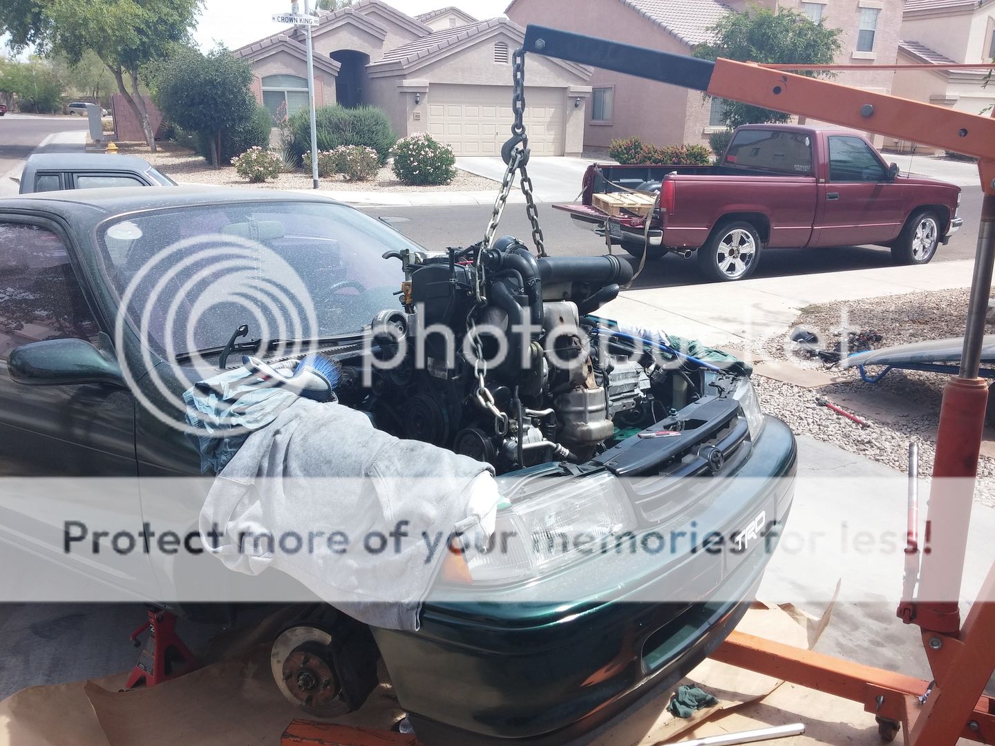

3E out

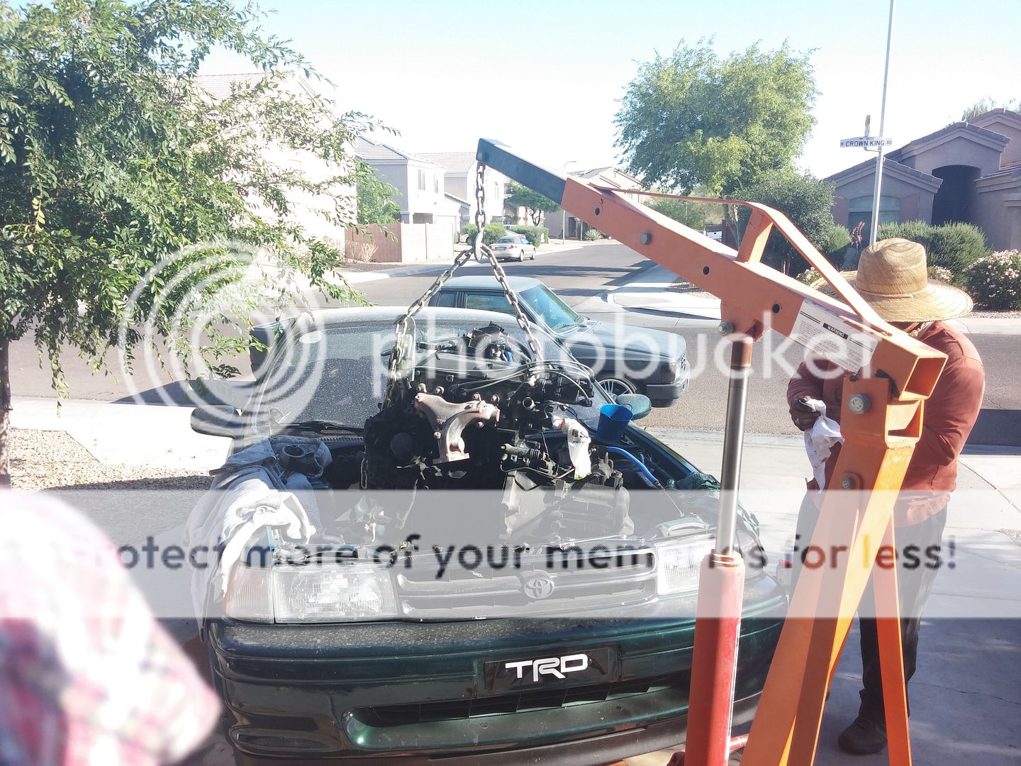

4efte in
after the engine was in went ahead and sent the 3e and 4e harness to rev, during the wait i decided to check the engine and paint the valve cover aswell.
Couple weeks later rev sent over the harness connected it and started the car. Engine started up very easily and with no hiccups.

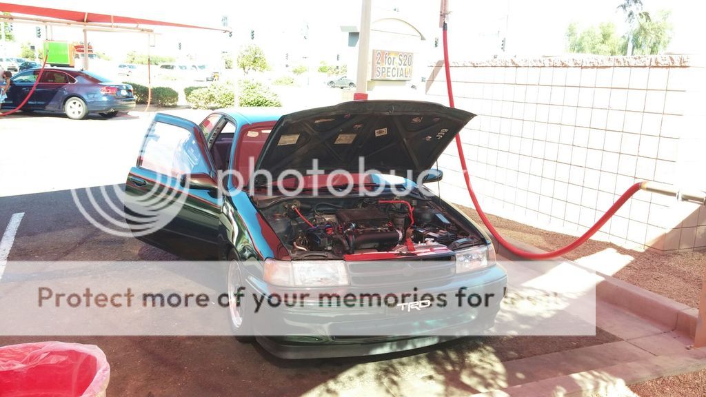

at the car wash currently how it sat for a while.

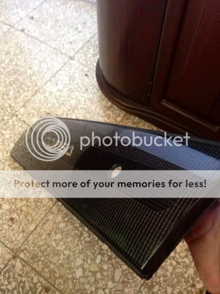

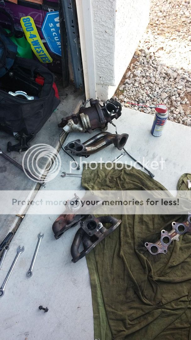

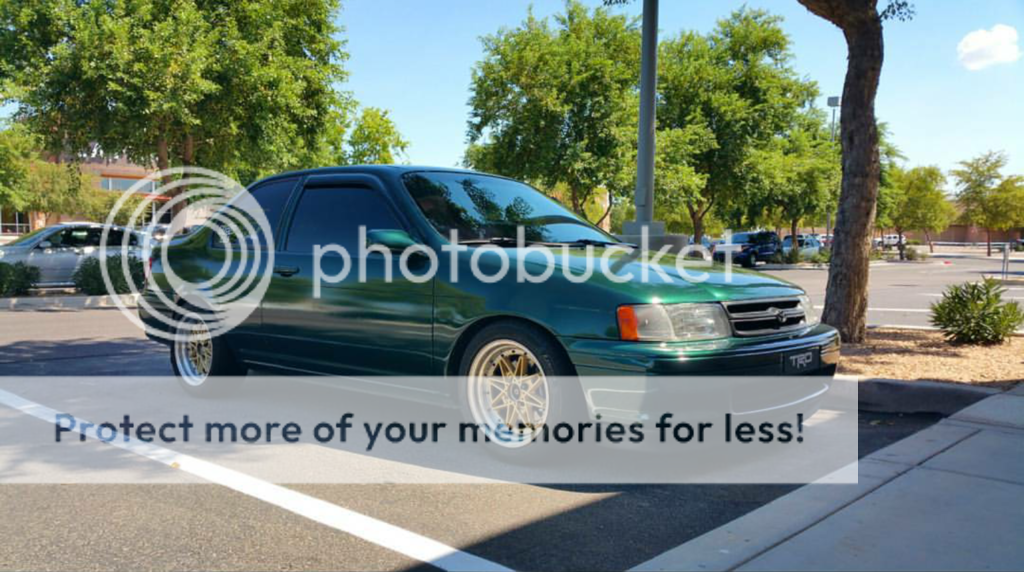

Had some things done to the car such as a clear cam cover, adjustable cam gear, Arm rest, corolla short shifter, put the stock steering wheel back on also, 2core rad gave up and bought a 3core civic rad and put the stock tercel fan/shroud, also got paseo front brake rotors and calipers, Corsa rear garnish shopped from DR, strut bar i got from ebay,TRD racing seat belts(show only) Madrpm also sold me his old ct9 WEPR manifold and Speedvision DownPipe and a new set of rims 15x8 Drags

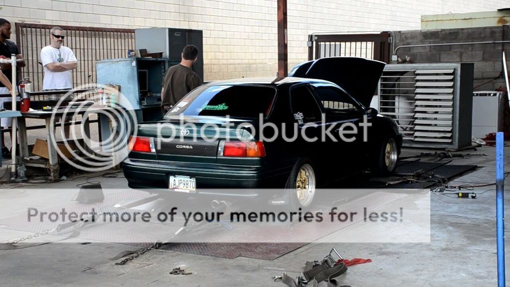

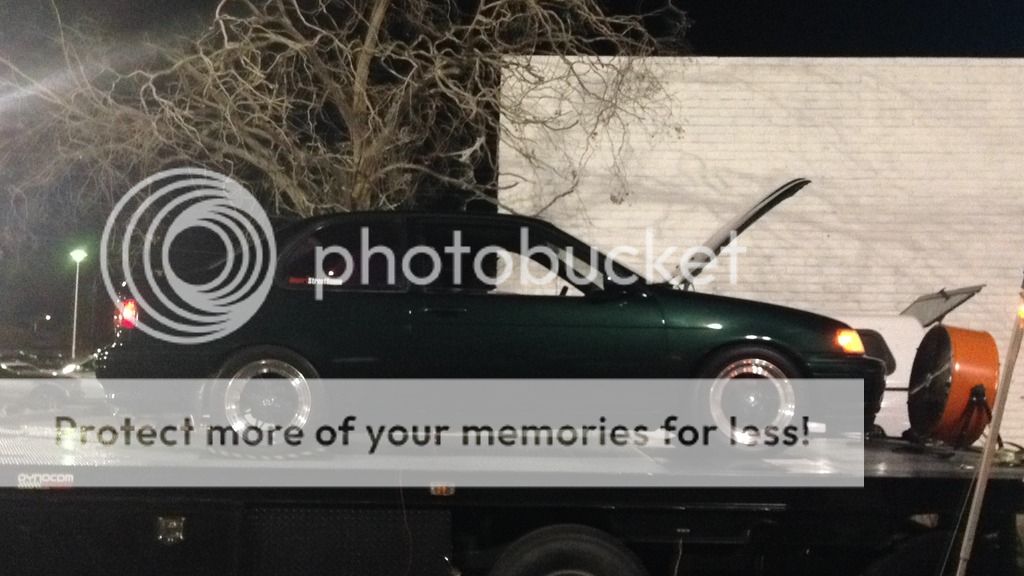

couple weeks later went to a car meet/event and decided to dyno my car.
Made 132hp and 147trq @ 12psi with stock manifold, downpipe and tmic
forward just a bit..:bananamac:
This is how the car looked about a month ago.
Went to a dyno event to see what my car made with the Manifold and downpipe. Car made 131hp and 137trq at 8psi.

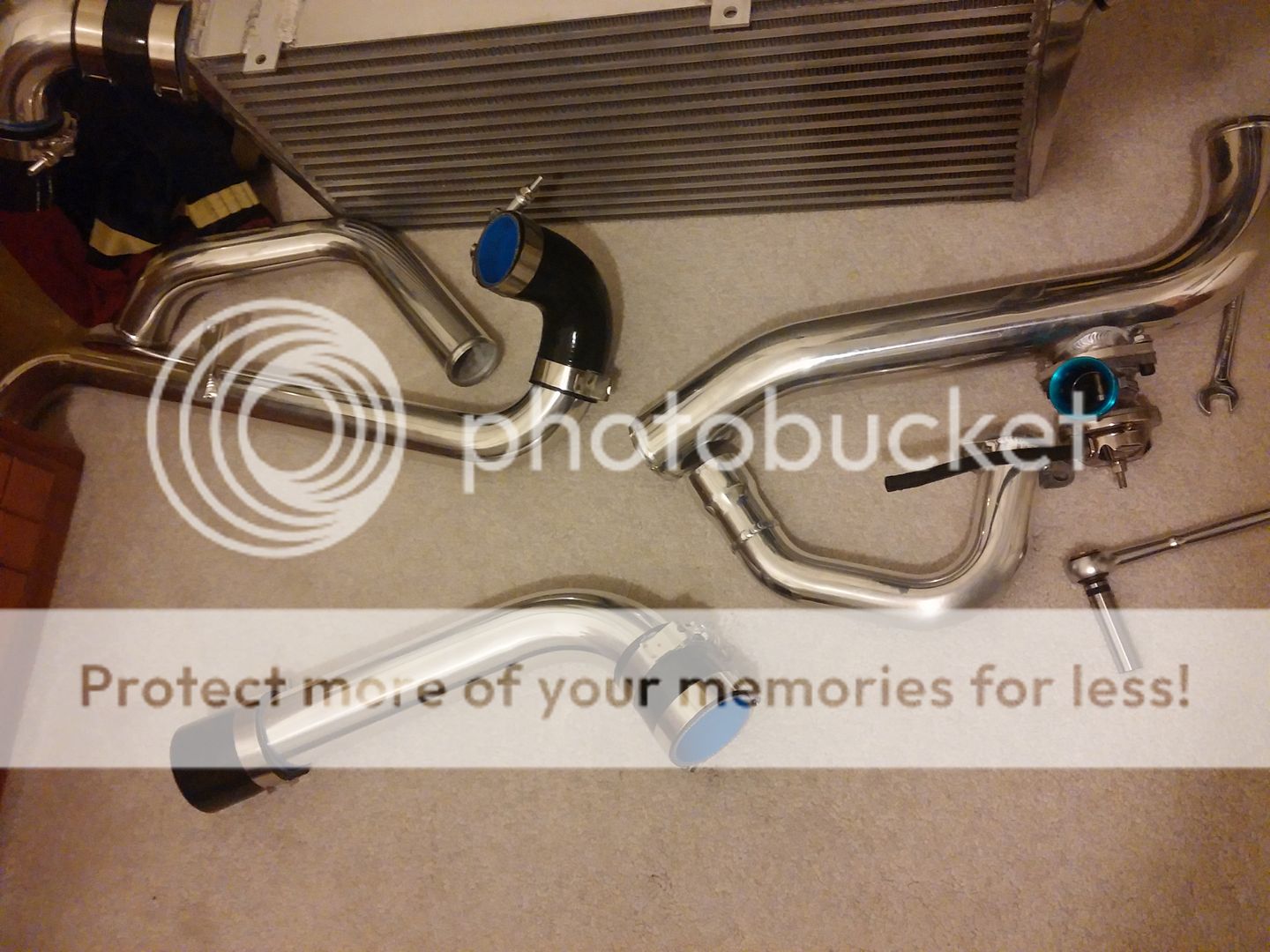

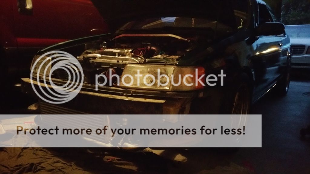

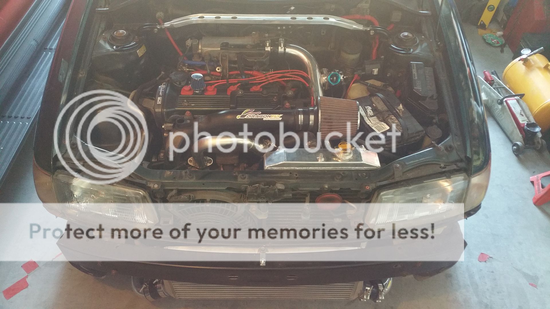

fast forward a tad bit..:bananamac: car is sitting in the garage. i had ordered a fmic kit from ebay for a 4efte and havent been able to install it due to the car being my daily. after finally being able to put it into the garage. I decided to work on it installing the fmic. currently this is how the car is sitting.:oops::naughty:
As of now im just waiting for a 2.25 coupler, 2.25-2.50 coupler and a slim fan w/ shroud. so will update here when i have those.

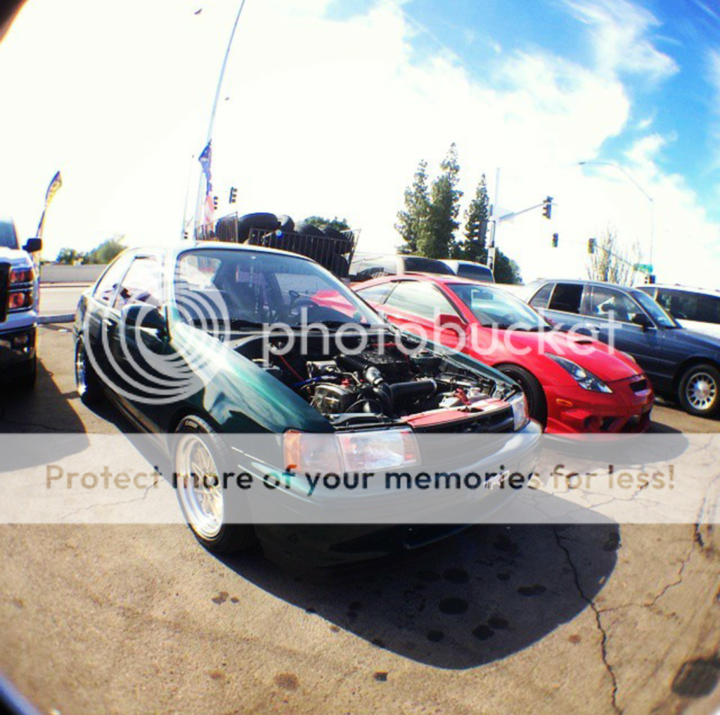

@117 LOL thats funny man, but yea i will update the WIP and also the chat. heres an update on how the car currently sits as of today.
:pics2:
How the car looks like.:pepper:
And final pic of how the engine is looking. :lachen::smug:

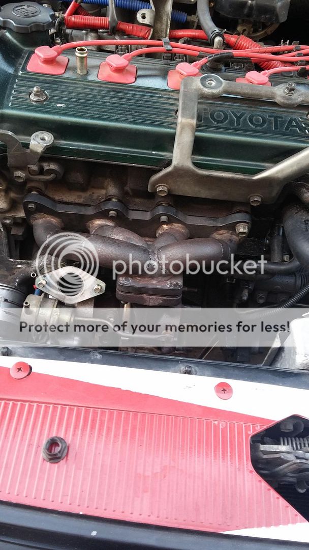

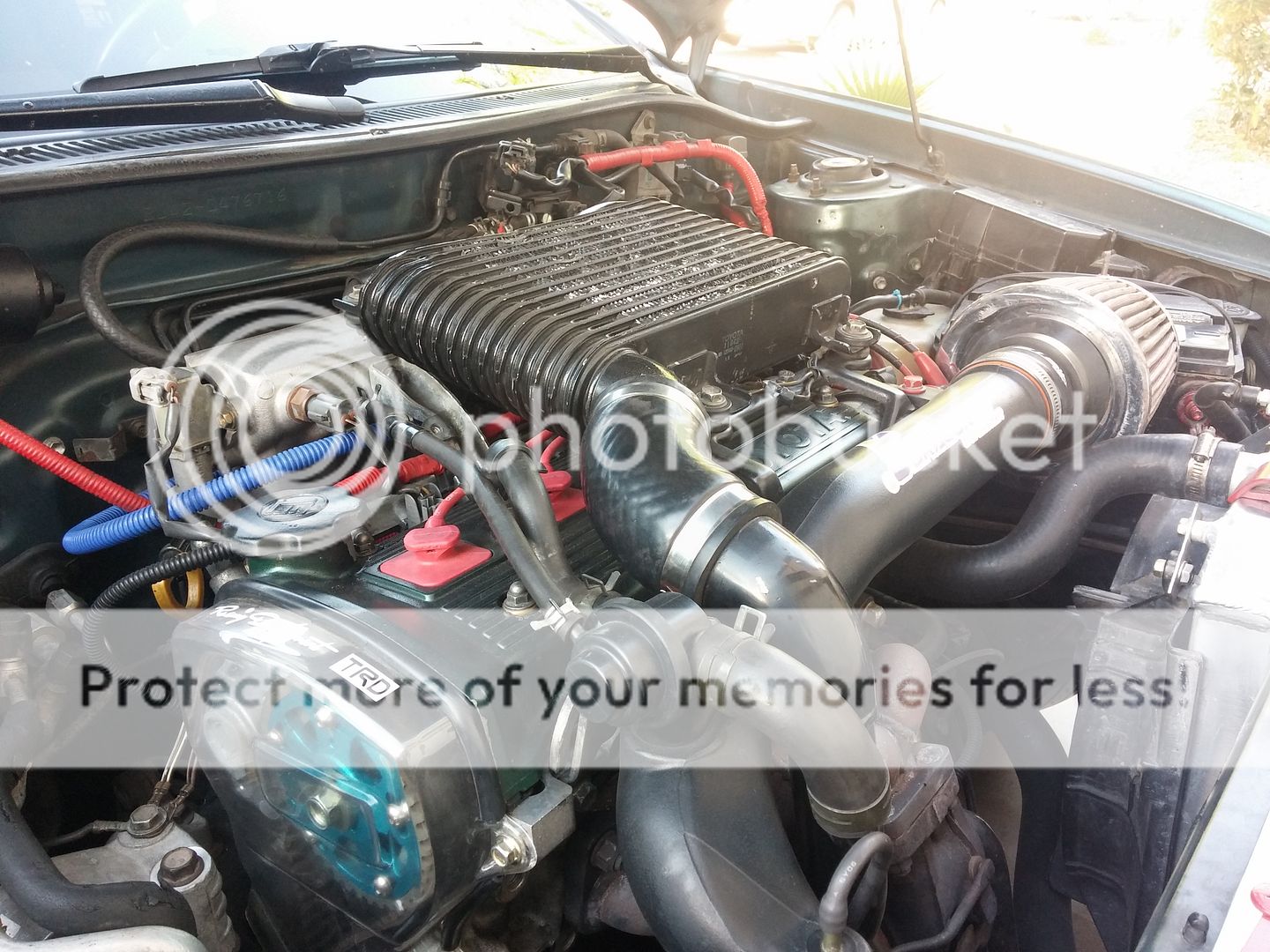

Alright so only thing I have done so far was order couple of clamps and an oil catch can. Basically ran ir from valve cover to catch can to turbo inlet.:2thumbsup:
Closer look!:thumbup:
[*] posted on 12-2-2016 at 01:35 PM
You'd rather splice that blue hose on right side and up catch can in there. Running it in front of turbo if any gunk makes it past catch can it'll go inyo turbo compressor and could make the wheel out of balance. An out of balance part that spins more than 20,000 rpm is a self destructor.

@tercel GTS yea that's very true. I might do that but from what I was told this setup should be fine. If I were to out it on the actual PCV valve I'd need a vented Catch Can.

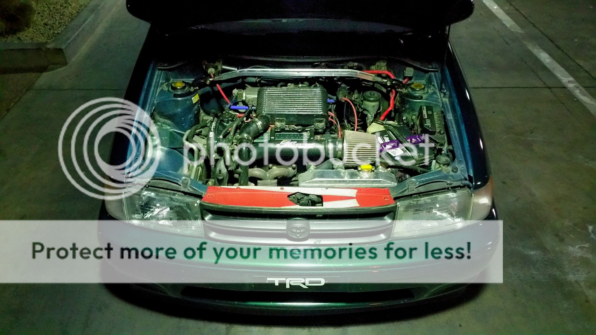

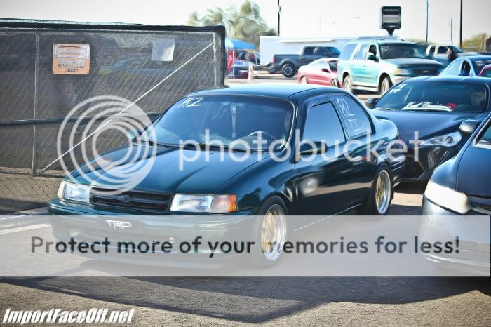

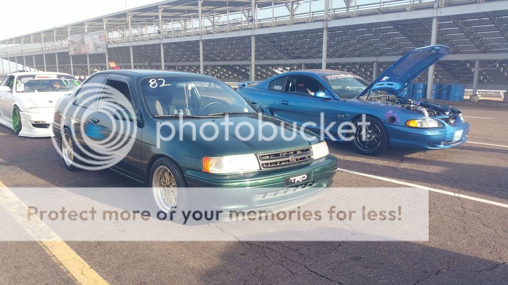

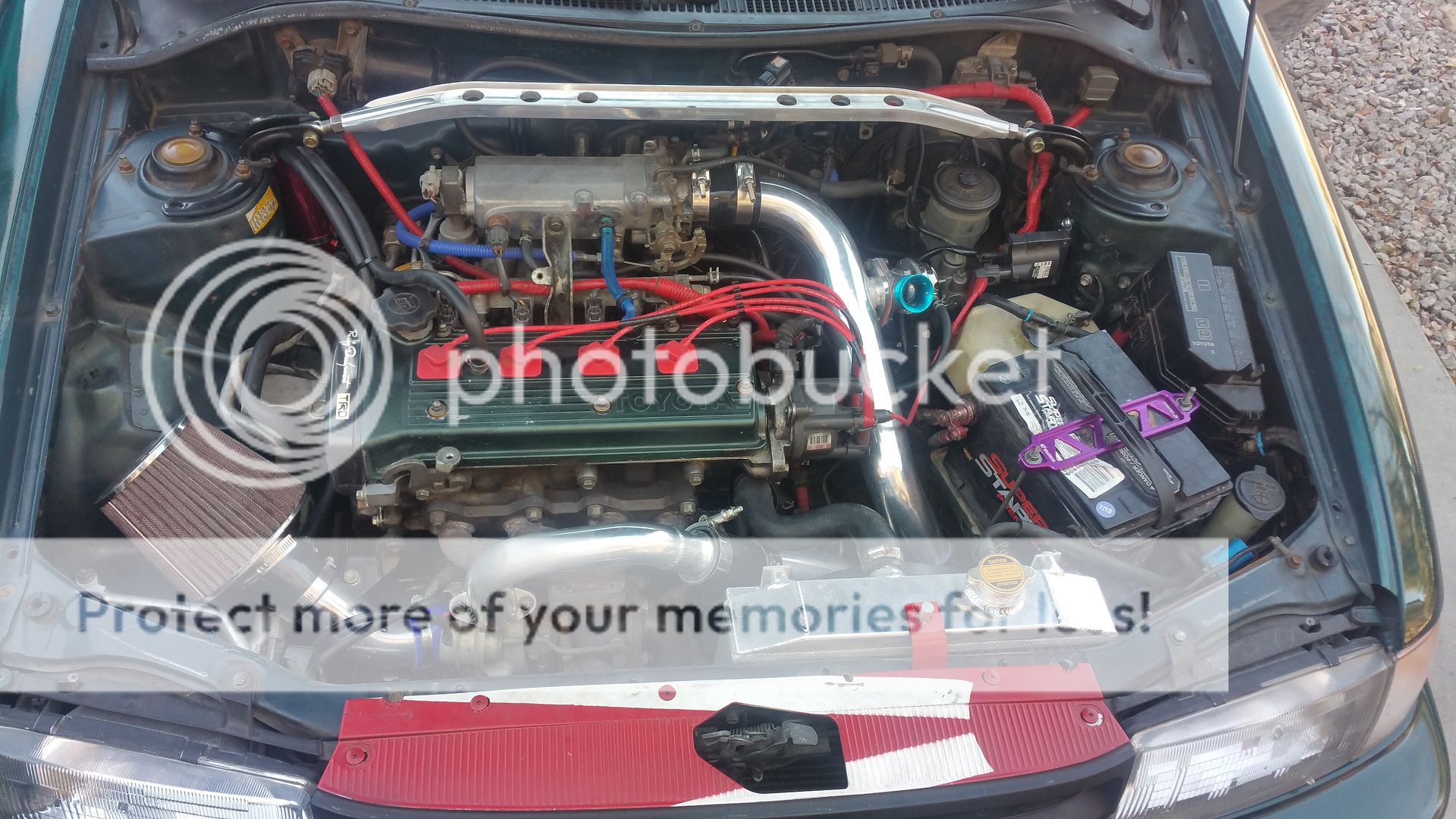

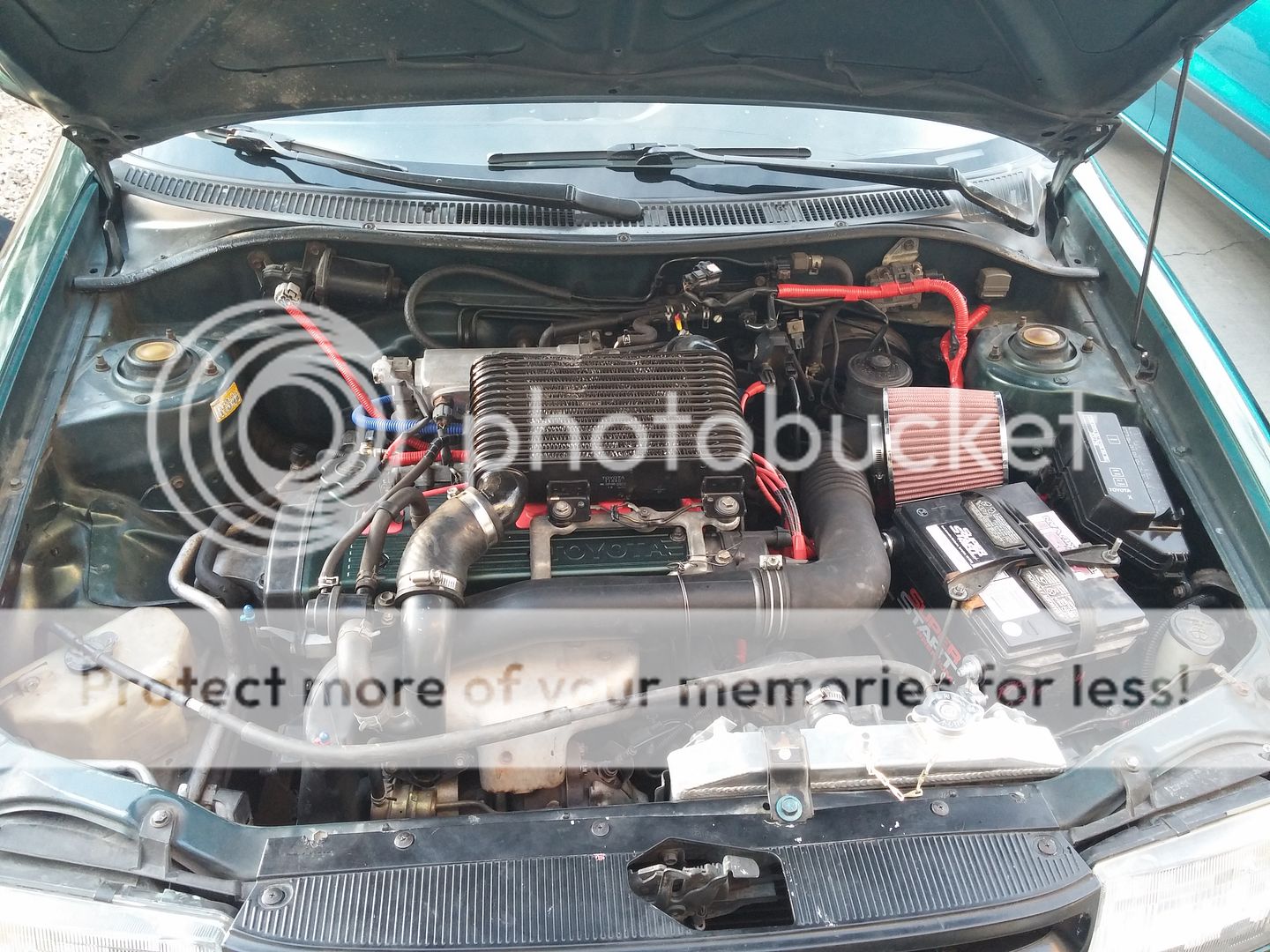

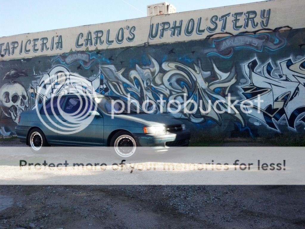

Hey guys so I haven't updated my WIP in a while a lot of things have happened recently. So far I've installed an anti lift kit to reduce the wheel hop. Also installed an HKS adjustable actuator. Aswell as went to 12psi. To top it off I went ahead and got some NT05 205-50/R15 for the front. Reason why I got those was for Import Face Off which was yesterday 3/13/16.
Here's a quick picture of how the engine bay looks as of now. Also got a UR strut bar.
This is how the car sits with the nittos 205-50R15.:pepper:

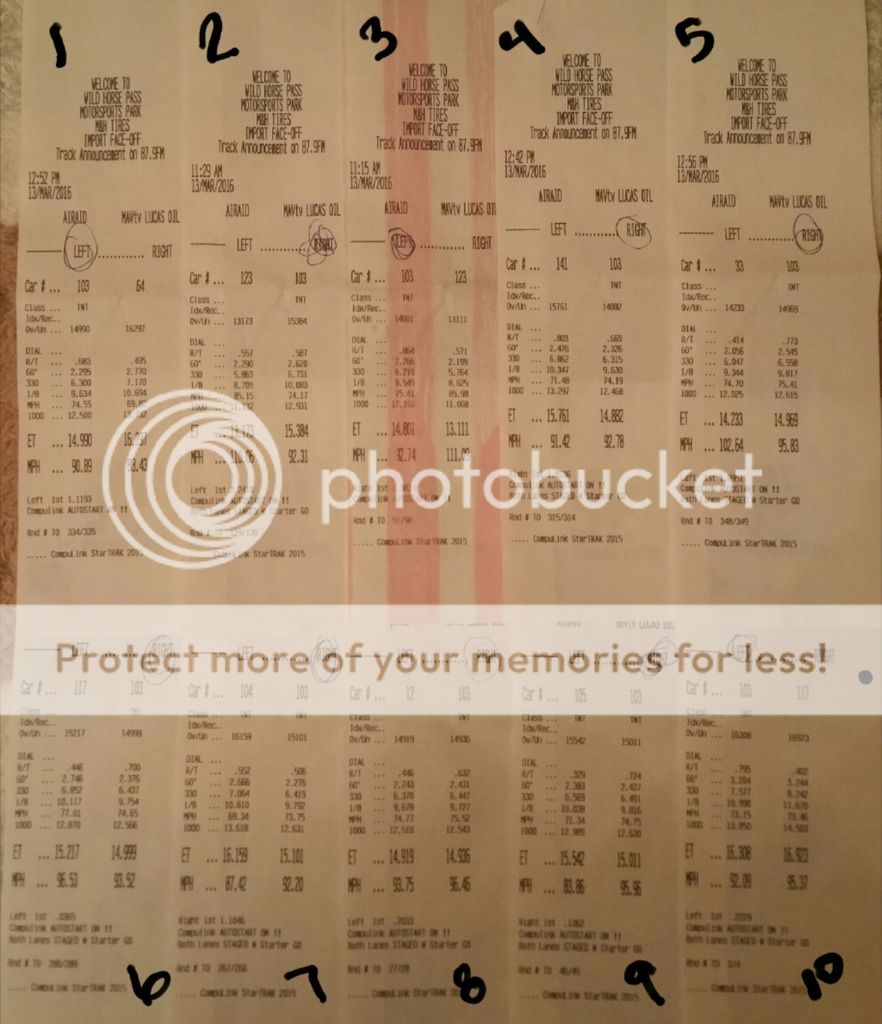

These are the time slips I ran a couple times most of them were consistent but over all I'm good with the time I got. 14.801 isn't too bad I guess lol
Time slip of the best time I got that day.:smug:
