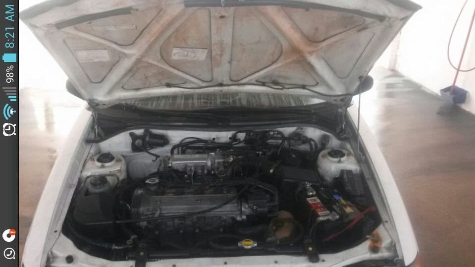

I plan on replacing the battery with the proper sidepost one, and grabbing a hold down from the local junk yard to clean that up and then I'll be able to restore the rad overflow tank to where its supposed to be and try to clean up my engine bay some.

[*] posted on 10-8-2015 at 08:45 PM
Quote: Originally posted by TheDemon
I plan on replacing the battery with the proper sidepost one.
Care to explain?
Posts: 399
[*] posted on 10-8-2015 at 09:23 PM
hmm i was thinking, i have not seen a tercel using a sidepost battery before, seems weird :dunno:
[*] posted on 10-8-2015 at 09:43 PM
Because it's the most terrible design of a battery.
I could choke GM for putting that crap in a 4th gen F-body.
TheDemon
Registered: 19-7-2015
Location: PHX, AZ
[*] posted on 10-8-2015 at 09:48 PM
i figured sidepost was what it came with because of the style crappy connectors it had on it when i got the car. either way i need to get the right battery so that i can fix that area under the hood.
- The Demon
94 Paseo 5-speed (WIP)
[*] posted on 10-8-2015 at 10:04 PM
Someone probably replaced the originals with a $2 Walmart special.
thoughthard2comeupwithths
Moderator
Posts: 3811
Registered: 25-8-2002
Location: outside shoveling snow
Mood: :dunno:
[*] posted on 10-8-2015 at 11:15 PM
My 92 has a top post battery.
Those battery terminals are not even close to OEM.

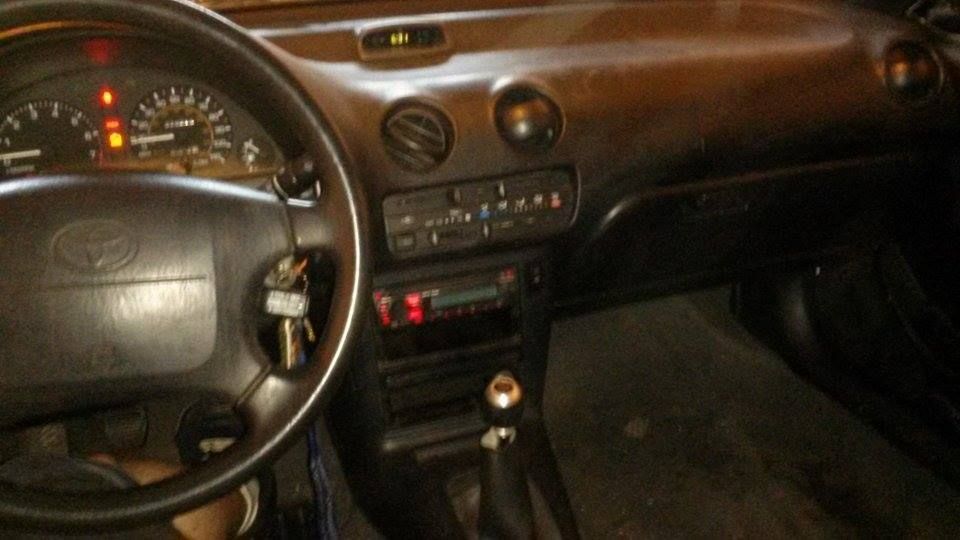

shifter shipped out today and should be here by next wed. also keep an eye out for an updated interior shot coming soon.

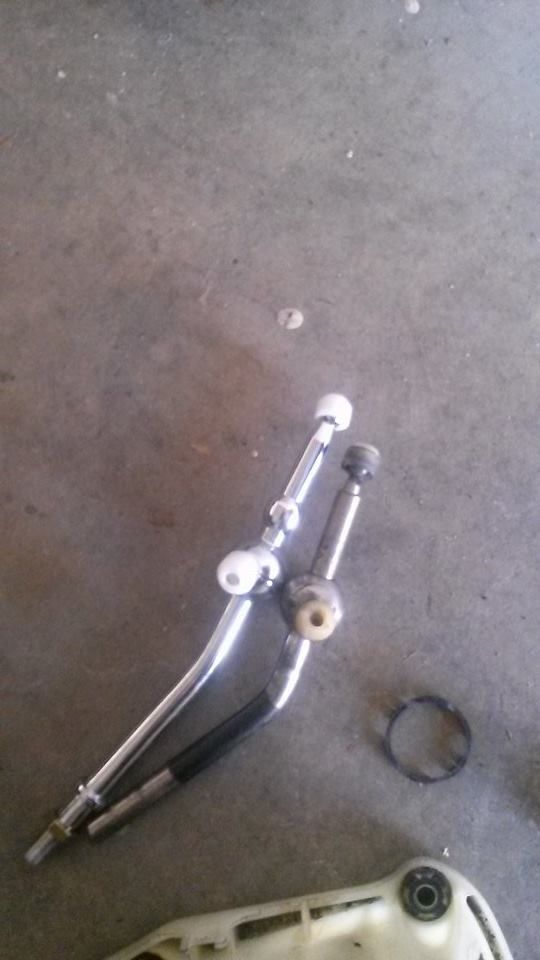

Shifter arrived early, pics will be up tomorrow

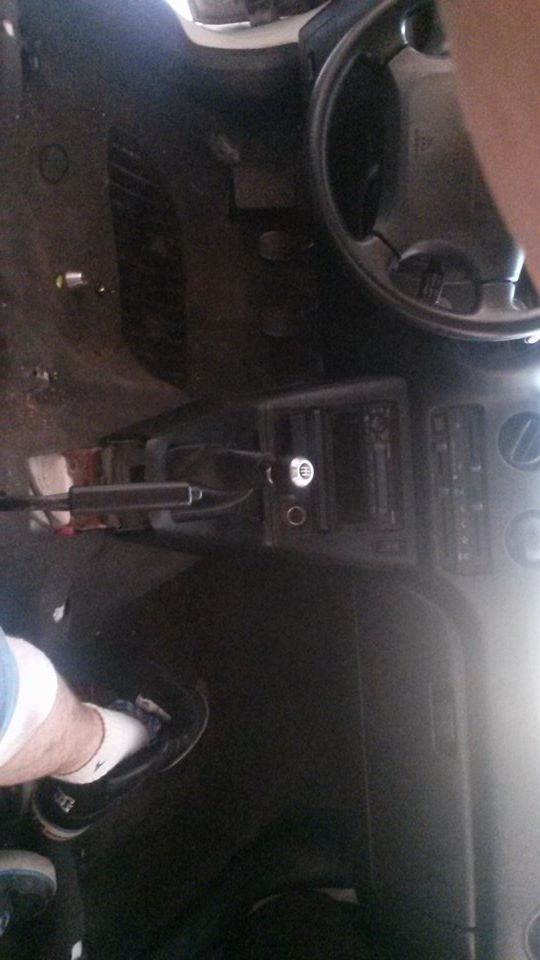

[*] posted on 18-8-2015 at 12:33 PM

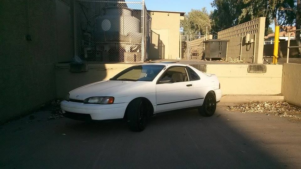

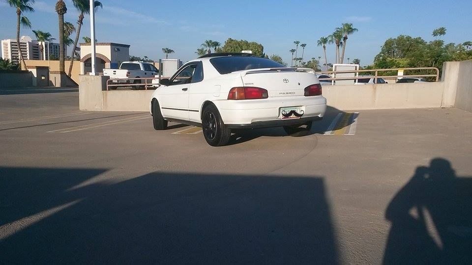

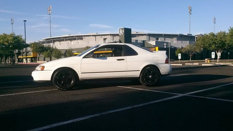

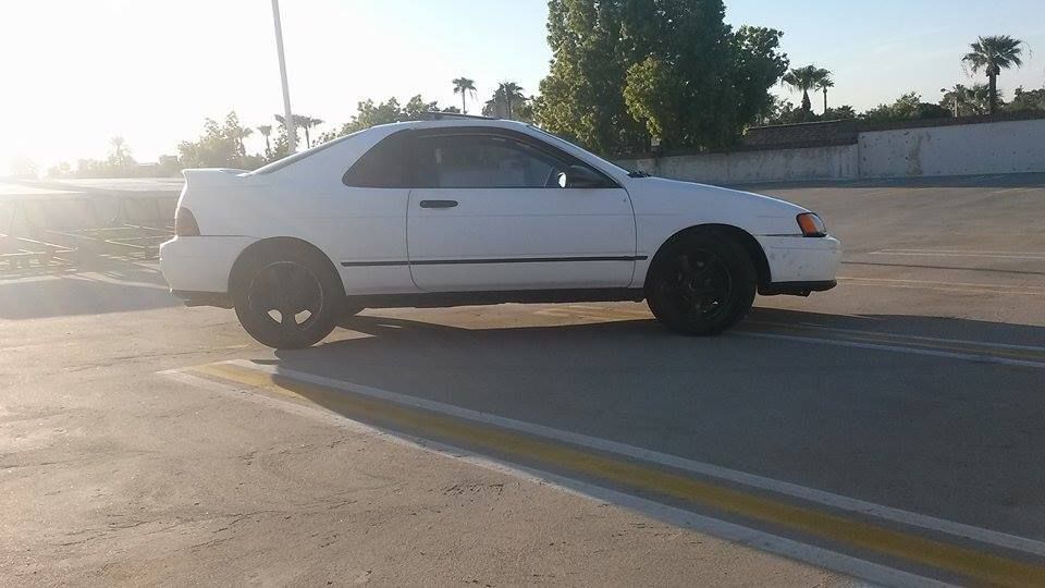

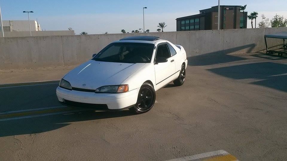

ok so i washed the car and did an impromptu photoshoot yesterday.

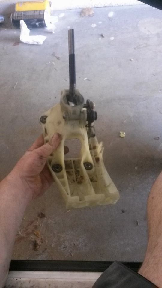

[*] posted on 19-8-2015 at 05:22 PM

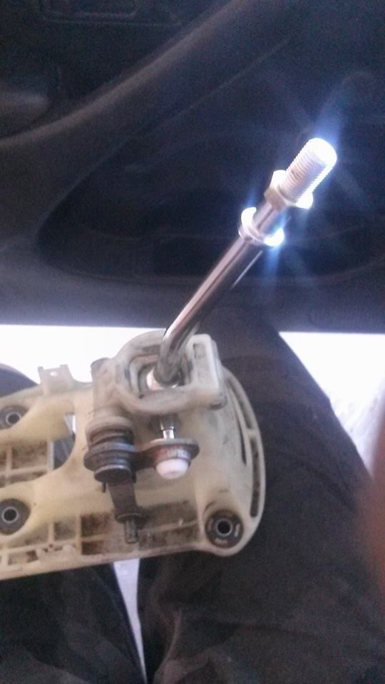

Try this with your old shifter....
Quote: Originally posted by Qballcious
once you get the plastic cups off.
jam the stick into the vise upside-down with the pivoting ball aprox 2" above the vise jaws and tighten it as much as you can. Then grab a torch and heat the ball. Some models used a type of "lock-tite" to keep the ball in place aswell as friction. If it's got the "lock-tite" in there you'll see it bubble and steam as it boils out. Then grab a couple of soft-metal washers and place them onto the stick so they rest on the ball. This will protect the ball from getting dented. Then grab a 8" long piece of a thick-walled pipe that just barely fits onto the stick, and slide it onto the stick so itrests on the washers. Then pound the hell out of it with a 3lbs hand sledge. It will eventually slide. Don't worry about the stick getting a little scraped up in the vise. That can be sanded/ground smooth later.
Trust me once this is done all that BS is gonna be worth it.
