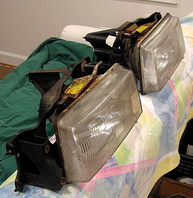

Not sure if you've seen THESE from my collection of 3rd Gen items:
A Gen. 3 Tercel cluster (with CLOCK!!!) $70.00 (Shipping included)
...also, still available:
Gen3 Headlights (with buckets)... (Maybe for sale)
Make me an offer for both and we'll see what happens?
I'm thinkin' along the lines of $180.00 for both (shipping
included)?

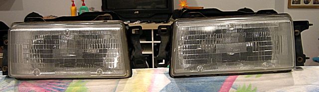

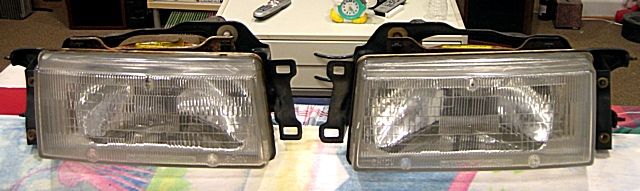

Just Back From Crazy Ray's (04-20-12)
With ANOTHER SET of 3rd Gen headlights (w. buckets),

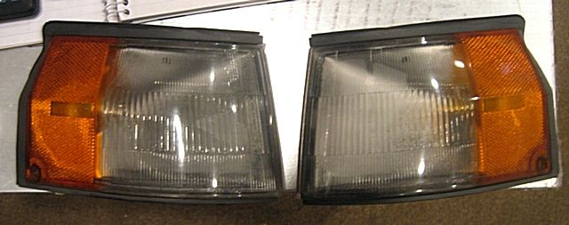

Very CLEAN set of 3rd Gen corner lights for $40 (will not break up set) Shipping included

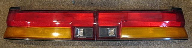

and a set of VERY CLEAN tail lights for a sedan.
Let's make a :deal:

alfradio, all of those items are fine in my tercel -- the car was in amazing shape when I got it last year, I've put some major wear on it though.
