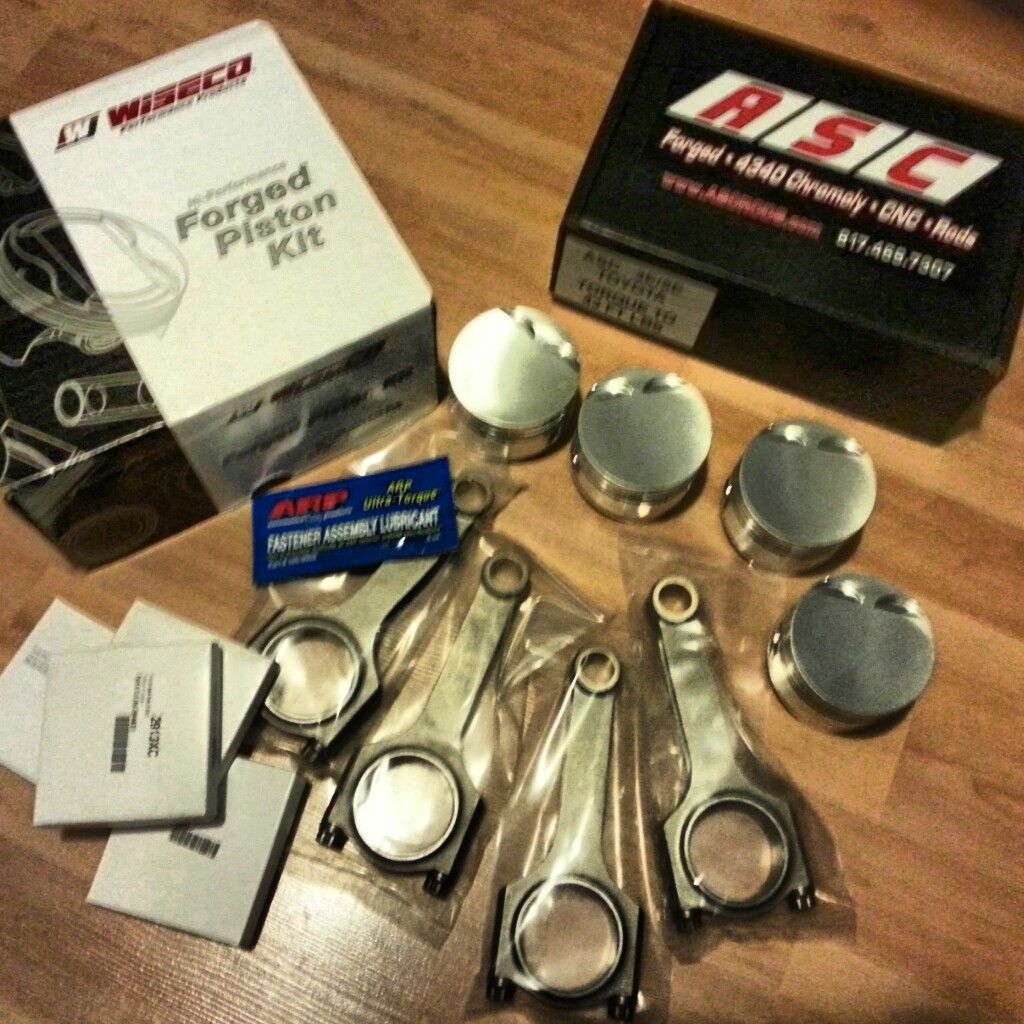

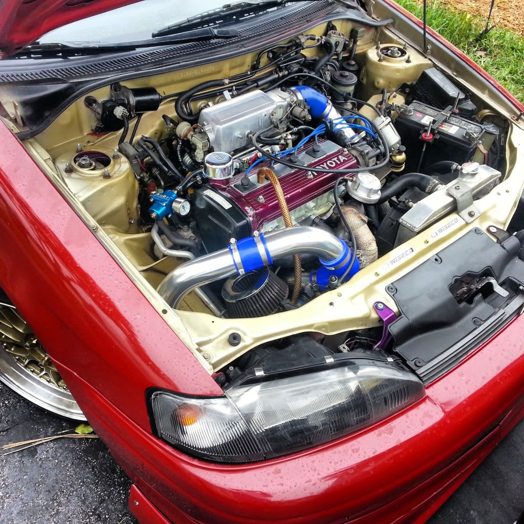

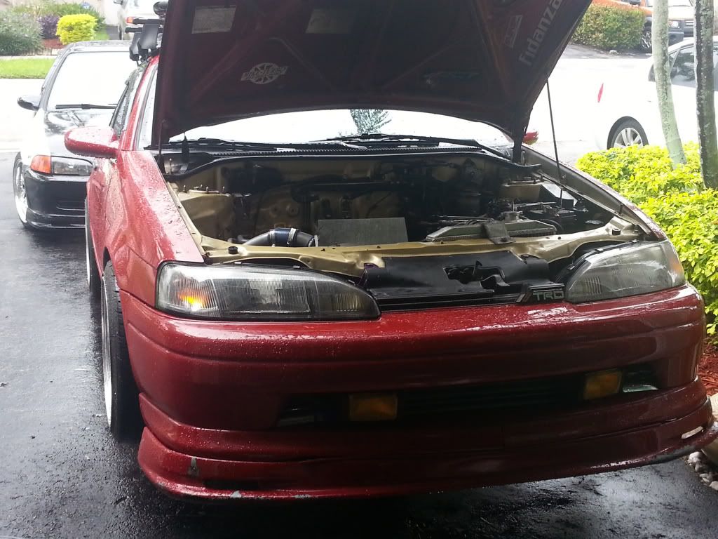

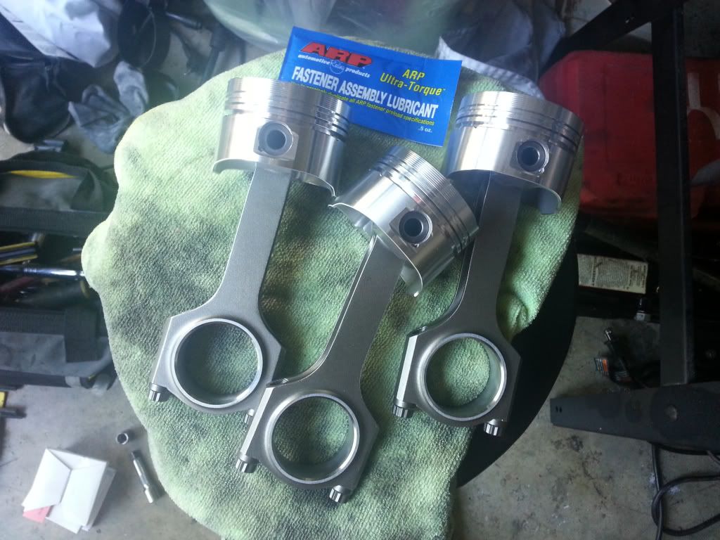

I finally got some pics uploaded to post here. I finished putting the engine back together over winter break and now has over 100 miles on the forged pistons and rods and upgraded turbo
How the bay is looking
I will upload pics of the parts too

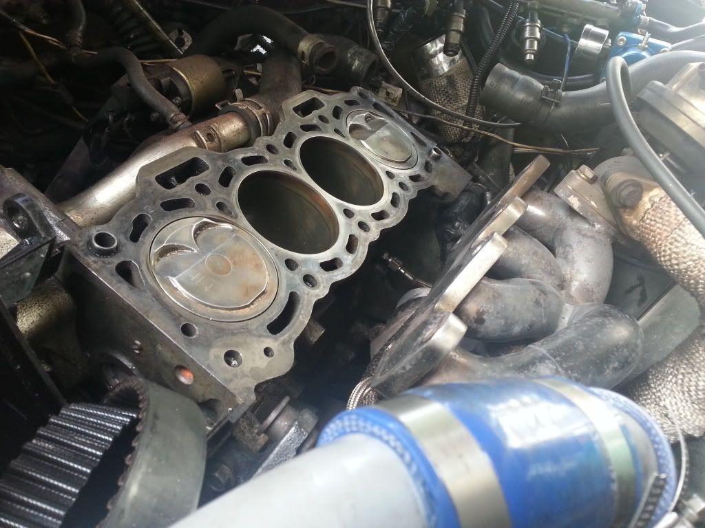

Some other pics from the build
Posted at the E.R
High compression pistons on 12psi for over a year before piston 3 craked.

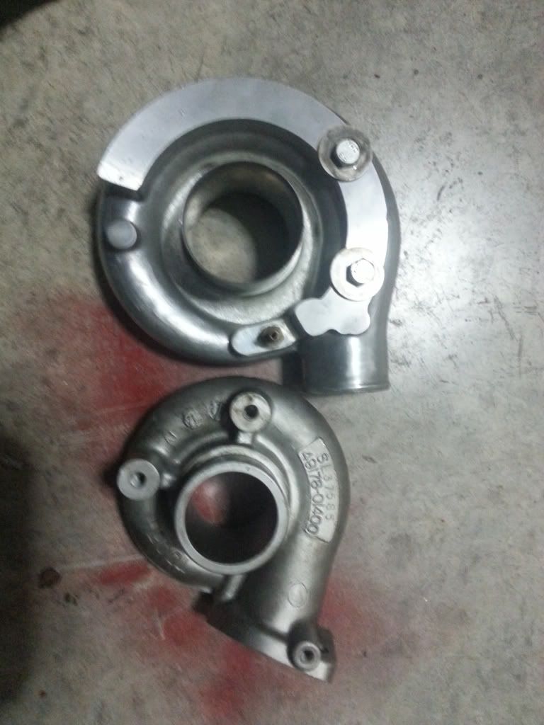

Got these from Alamo motorsports in Texas
Went from a 14b turbo to a 20g compressor housing and 20g wheel on the same td05 with a 16g exhaust housing
