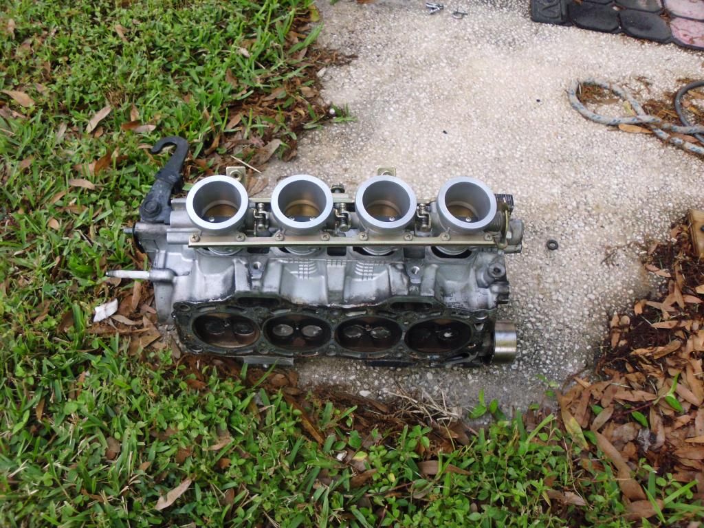

having a little fun with the ITBs
Pro tip: shoe boxes and Ice cube trays make it easy to keep the valve train organized
I 3D printed an adapter for the ITB to the stock tercel TPS

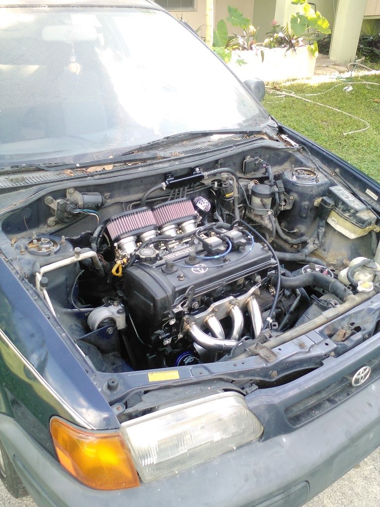

Engine is done
I need to rush as I want to finish the car for an autox event on the first weekend of October to test it, then the GRM challenge is on Oct 23rd.

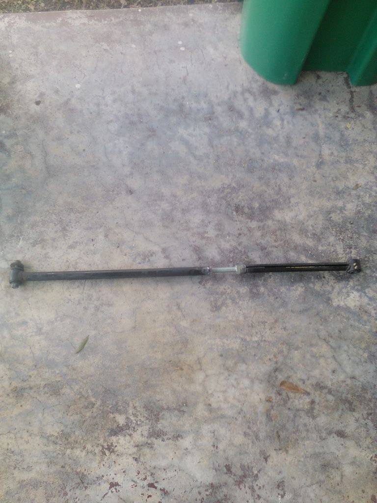

made my own adjustable panhard bar by cutting a piece out of a stock paseo one and welding in a nut and bolt.
