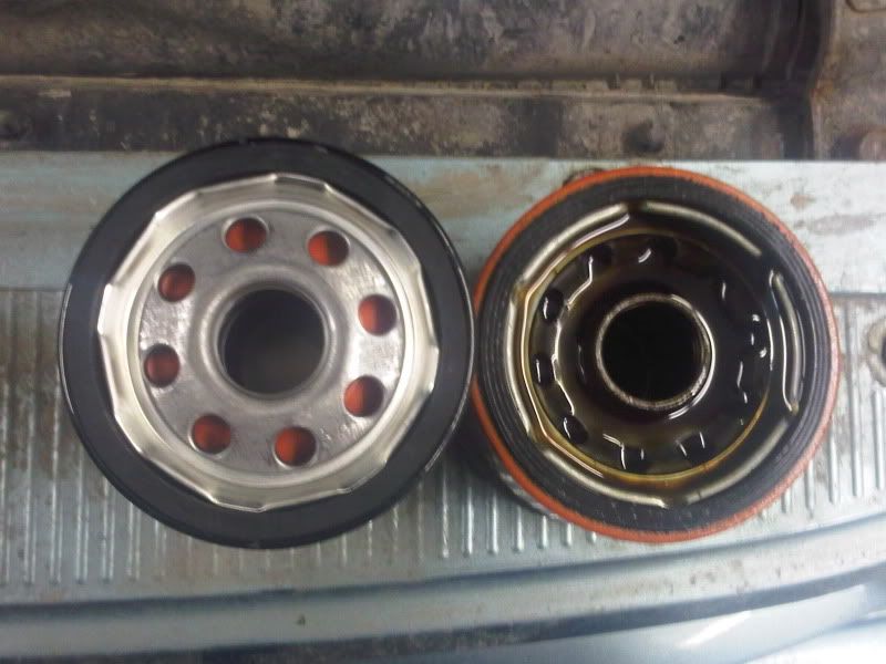

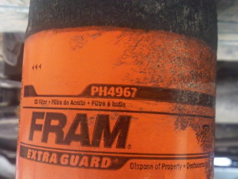

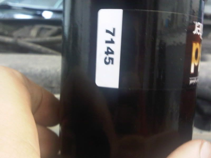

[*] posted on 10-4-2012 at 12:20 PM
Before
After
The main difference?
THIS
Some more pics
Mu:waving:
