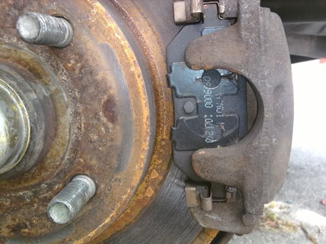

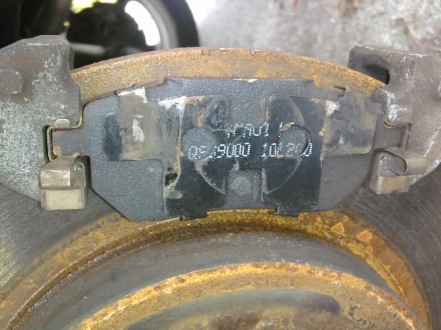

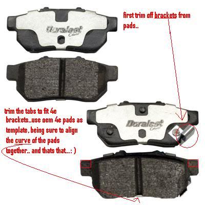

hi everyone...i got good news for those w/rear disc set-ups...pads u kno cost an arm & a leg and u have to wait for shipping...i was desperately in need for pads to the point i was rubbing metal to metal..:irked: i took a trip to the junkyard to find some that seem similar to our pads..thats wen i stumbled towards rear pads of an acura integra...they looked pretty similar accept for a cuple of tabs here & there but i thought they were close enough to try...i took me honestly about an 1/2 hour to do & they worked flawlessly :pepper: ...so dis is all u have to do...

stuff dis in ur engine bay!!!
[*] posted on 14-1-2012 at 01:04 PM
you failed to tell us what year/model/etc

[*] posted on 14-1-2012 at 01:07 PM
well the integra i took the brake pads off was a 94 model non vtech...

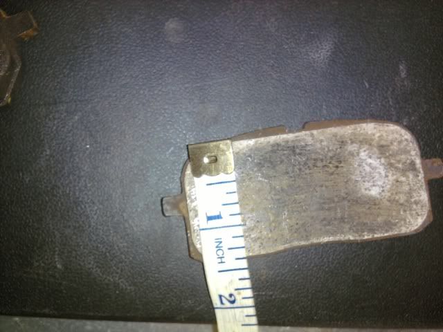

[*] posted on 14-1-2012 at 02:12 PM

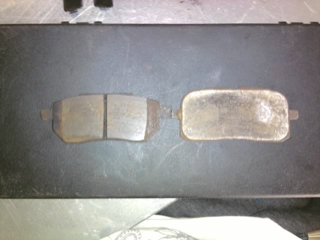

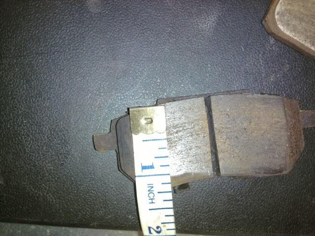

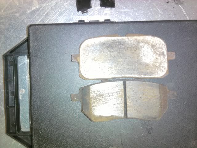

integra pad on left...starlet on right
starlet pad is slightly wider than the integra as you will see..
original pad 1-3/16in
integra pad..1-1/4in
& there you go... :thankyou:

Just did this, worked great! had to go back and shave a little off after the initial cutting of the tabs, but all the work took less than an hour and a half. Thanks again.
