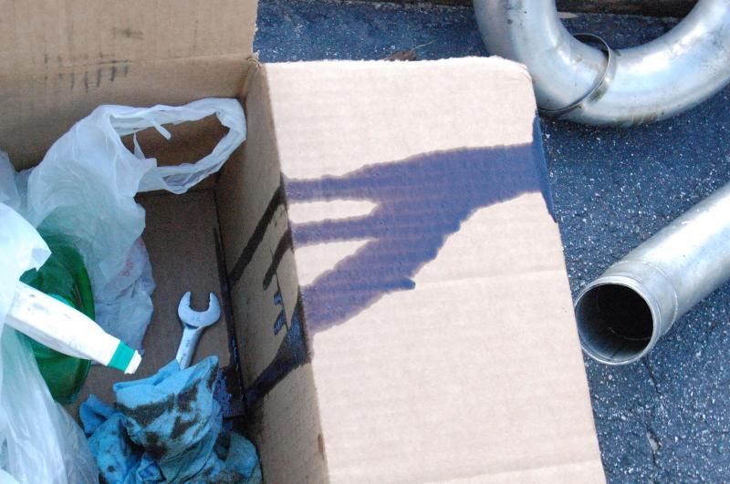

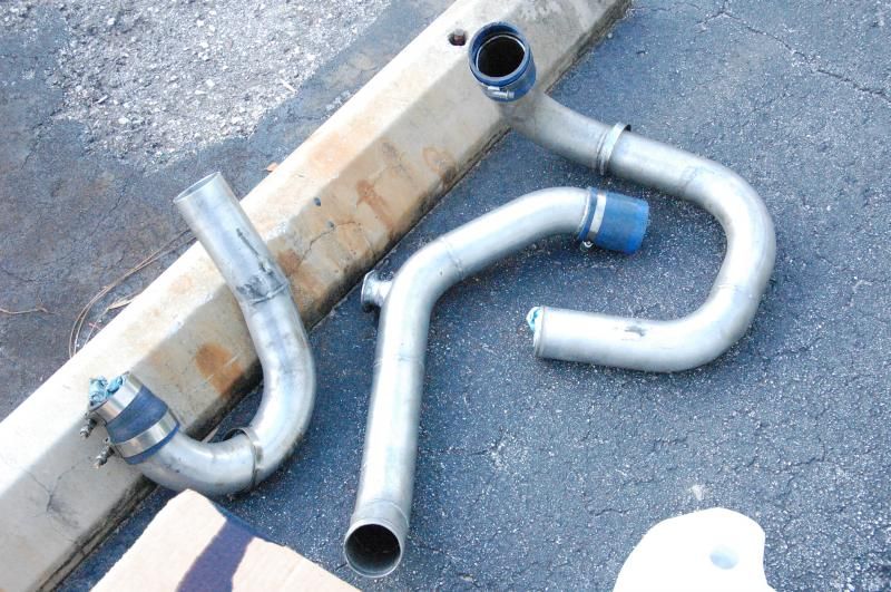

I proceed to clean my FMIC and the piping. Thinking the pipes were fairly oil-free, I was wrong. Got the FMIC cleaned too but I'll have to upload pics

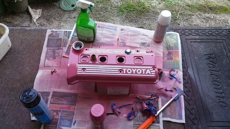

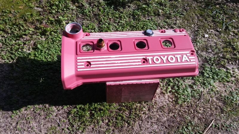

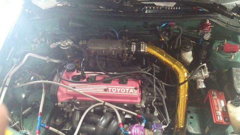

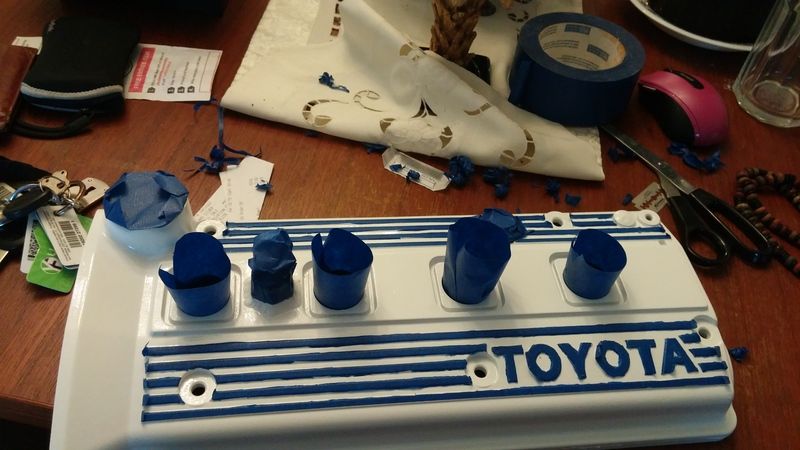

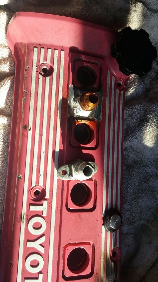

Remember the baller valve cover? Yeaaaaa, I decided to add a breather to it soooo yea... I repainted with not much success. The turbo drain got converted to a -10AN too

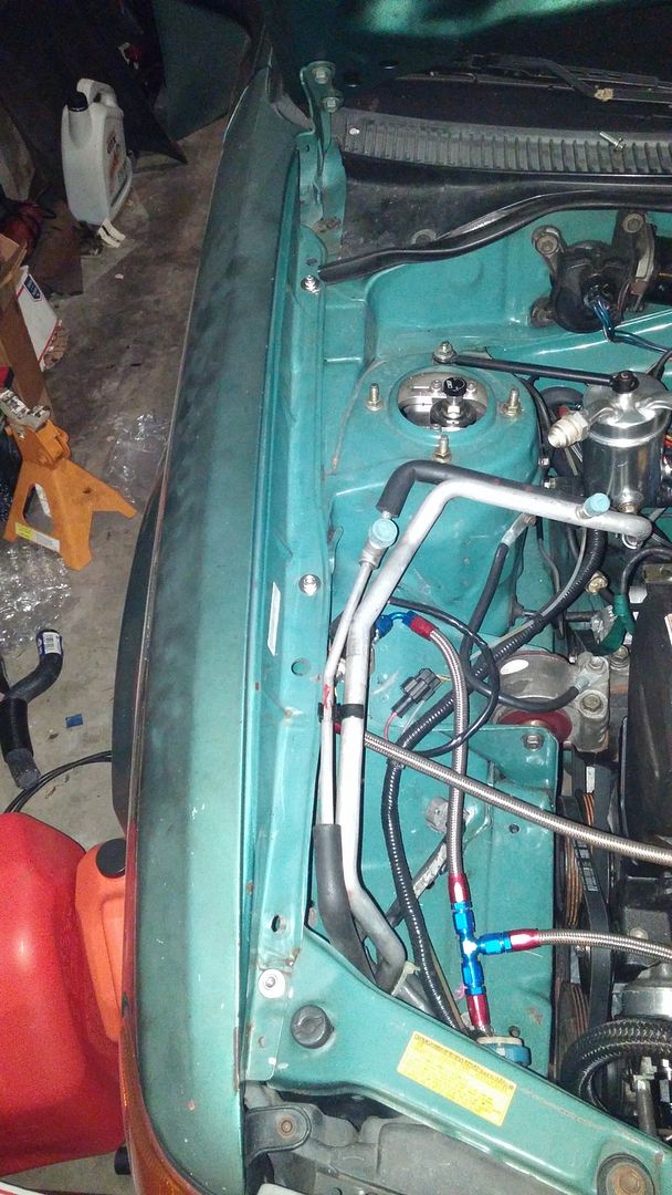

I also decided to convert my wastegate/ebc signal lines to braided lines too so I won't have a part 2
I wrapped the DP and wastegae dump tube and the charge piping cold side.

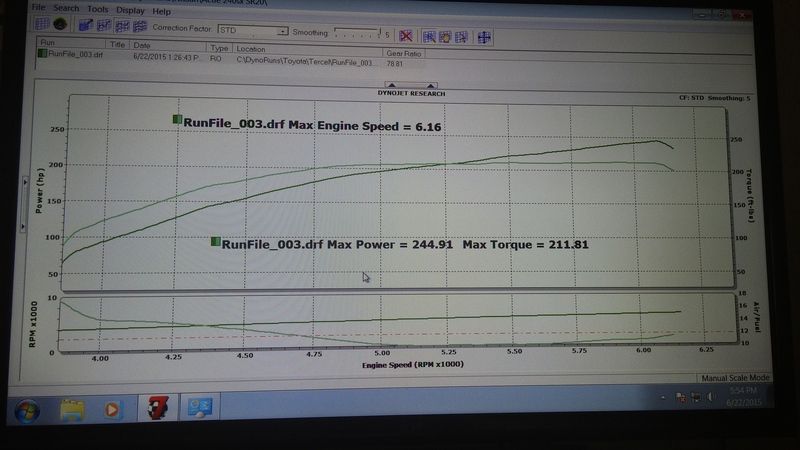

Being excited to get the car going, sent the car to a shop to get dyno'ed. She made pushed numbers. 2nd or 3rd pull at 16 or 17psi. Mind you the pulled stopped at about 6200RPM?
She pushed coolant

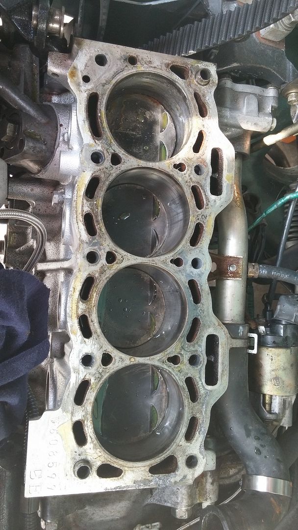

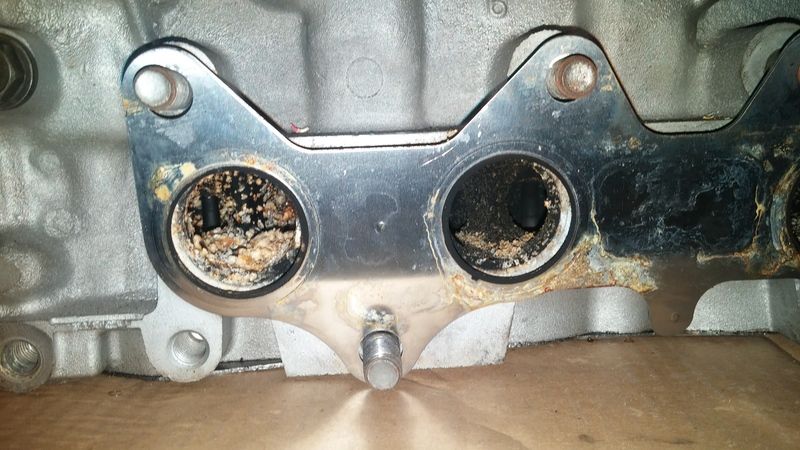

I went back to pull the head off and found
Replaced the headgasket aaaaaaaand

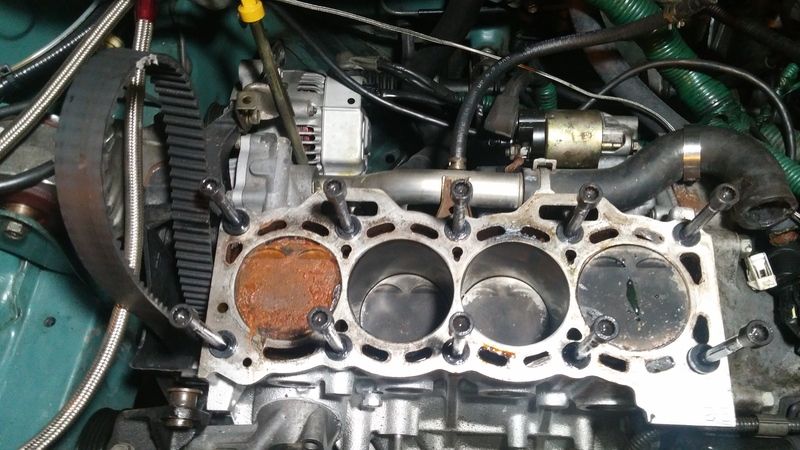

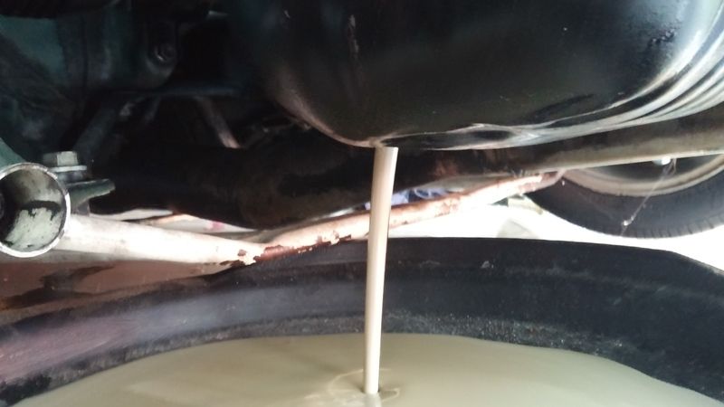

Pulled the head to fiiiiiind: That's right folks, cyl1 is flooded, cyl2 is wet, cyl3 is moist and cyl4 is bone dry

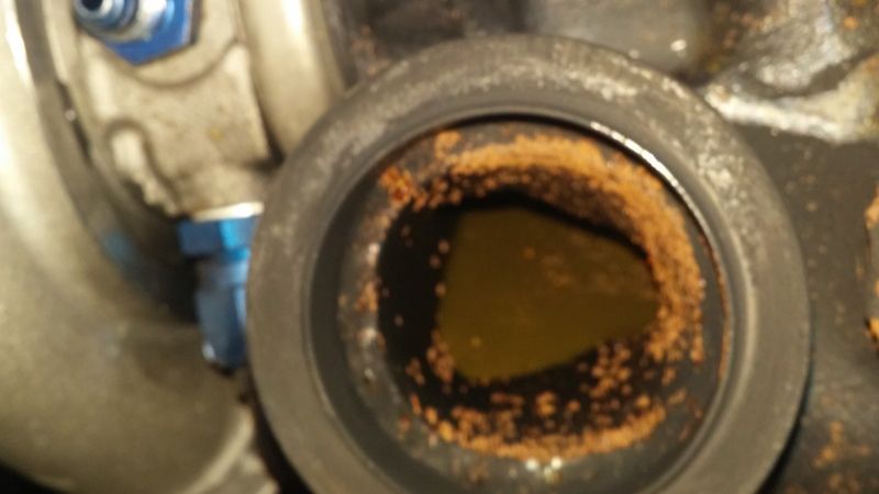

What the oil looked like when I drained it
Head is currently at a shop getting pressure tested, checked for a bunch of stuff too. Whether it checks out or not, the bottom end is coming out to get the block tested

Upgraded the fender fasteners

What fender fastener kit di you use?
And the way your exhaust port looks is familer... My water pump looked the same way when i pulled it off

I see the shiny bolts...looking new!! :smug:
