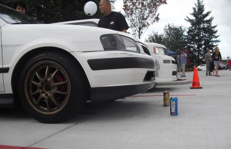

Is that you peeking at the top of the car on the second to last picture? What're the specs on those wheels?
haha yeah thats me, i believe they are 16" c10 replicas rattlecanned bronze
