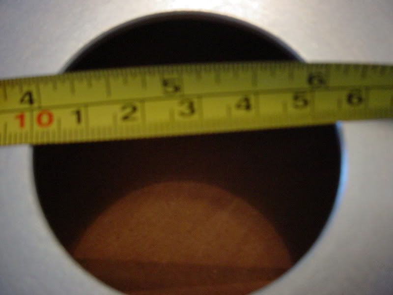

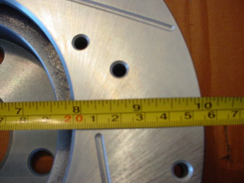

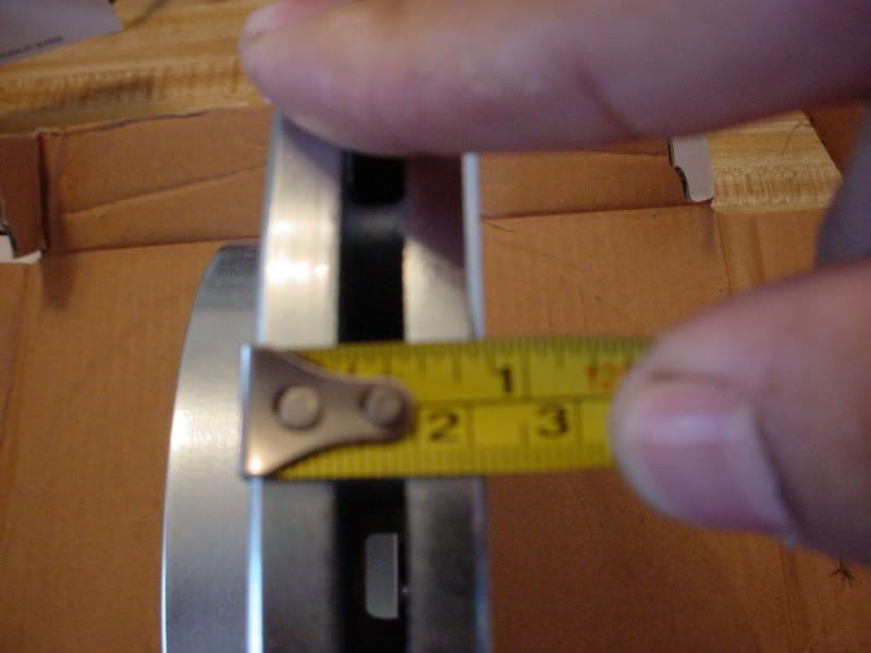

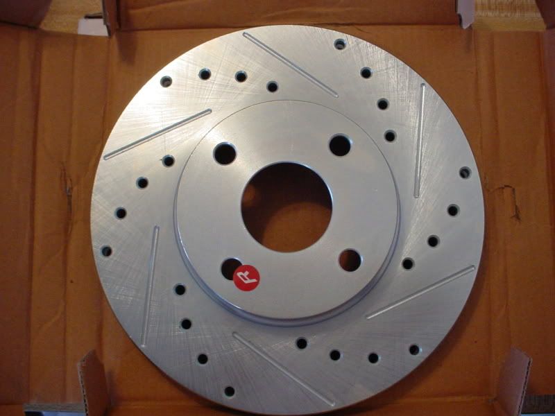

OK, Some teaser picks for now
4x100mm
55mm Hub
255mm Diameter (listed as 257mm)
22mm Thickness
I am just using a measuring tape so I know its not exact. But from my research this rotor will alow the use of the Corolla Calipers, as everyone knows bolt right on to the Paseo/Tercel, to be a truely 100% bolt on application, NO SPACERS NEEDED!
I have my Corolla Calipers and will be putting these on my Tercel on my next day off.
So Stay Tuned!:2thumbsup:

The rotor is from a 92-96 Mazda MX-3, and this rotors offset is 23.1mm that is exactly 3mm difference from the corolla rotor. So this rotor essentially has the 3mm spacer everyone was making for the Corolla Rotor.:thankyou:
