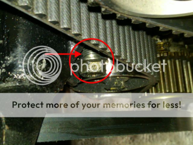

So for a while now I've been hearing this rubbing sound that I thought was my A/C compressor biting the dust. Turns out it wasn't. It was the passenger side mount, it unbolted itself from the block.
This was where the rubbing noise came from.
Tryna get at that one bolt behind the water pump pulley was a pain. If I ever have to buy a waterpump again, it's gonna be the one with the detachable pulley.:bah:

[*] posted on 11-10-2010 at 03:07 AM

Had I not rigged up that front 4th motor mount I'm thinking I'd be in a bit more of mess by now. I only noticed the tilt in the engine after I unbolted the 4th mount.
Red thread lock is now on. I was seriously considering some JB weld thread lock. :lachen:
Also, one of the nuts from the turbo-to-manifold flange were totally backed out. Only reason the nut remained was because the turbo housing prevented it from totally falling out. And another was 1.5-2 turns loose. No wonder the car developed a jerky midrange boost.

Yo Don why did this bolt untighted?
[*] posted on 11-10-2010 at 07:50 PM
Prolly forgot to put spit on it.:lachen:
No idea, my only thought, and hope, is that I never torqued it fully when I first did the rebuild. I say "hope" because if something else is causing it to just come undone, that's not good, but I don't think that's the case. I think I must've not done it up right first time. Hopefully those conrod bolts were done up right.:yikes::haha:
Like I said, I put red loctite so I think it should be good.
