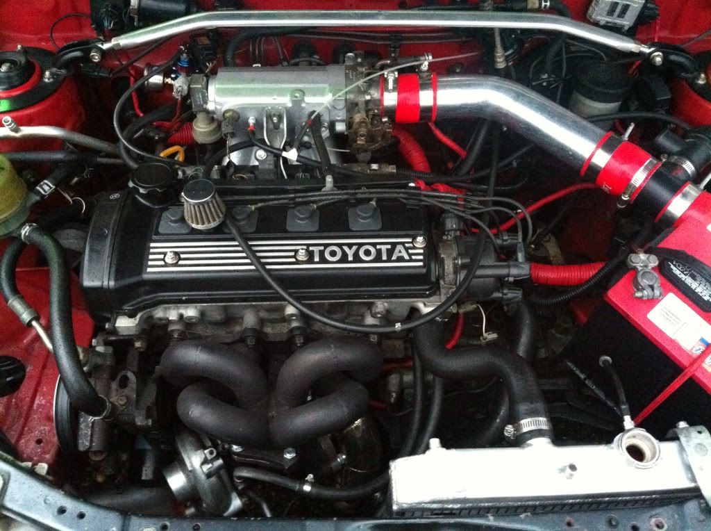

Current Setup:
4efte
Toyosports mild steel td04L kit
STI td04L Turbo
Supra 440 injectors
Gt-Revva Harness..
EMB...
AEM Wideband
Autometer Boost Gauge
2'' intercooler piping
DSM BOV
Sard fuel pressure regulator
Greddy Turbo timer

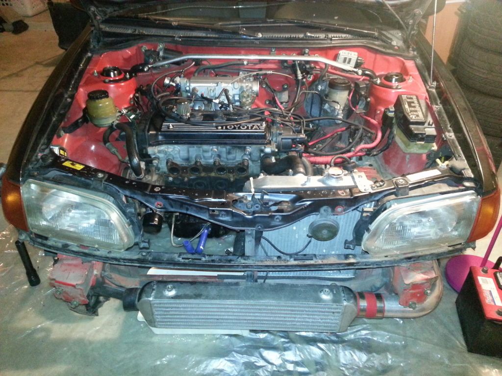

[*] posted on 18-1-2013 at 12:27 AM

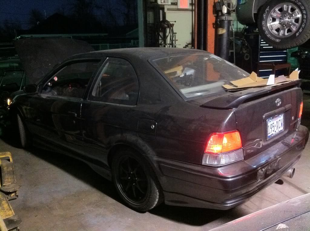

Update! well the car has been running okay for the last couple of months, havent really driven it since i bought this:
the car sat for a couple of months while i upgrated manifolds. bought a wepr ram style manifold and dp.
fitted a magnaflow street series muffler
this is how the car sits right now.

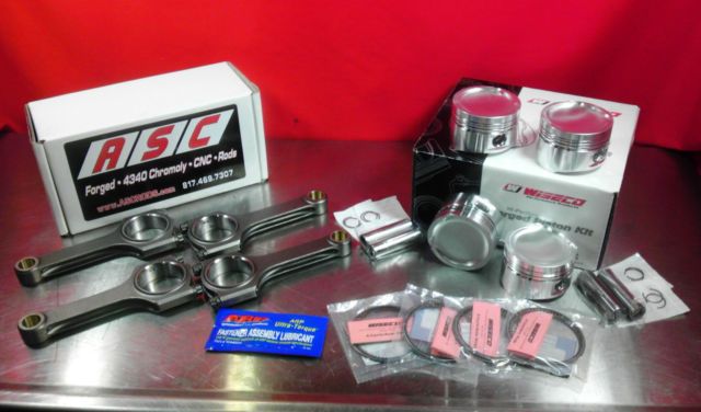

Going to upgrade to a 5e block, bought forged rods and pistons
as of now, im waiting on my new wepr evolution external wastegate manifold to drive the car again, also the paint on the car has completely peeled off, will get a paintjob hopefully next month. going with the new nebula grey from lexus that just came out with a darker graphite color hood and trunk.
my plan is
5E forged
-asc froged rods
-wiseco forged pistons
-4e head
-4efe tubular intake manifold
-WEPR TD04L Evolution manifold and downpipe
TD04L turbo
-tial 38mm wastegate
-EMB
-20 psi

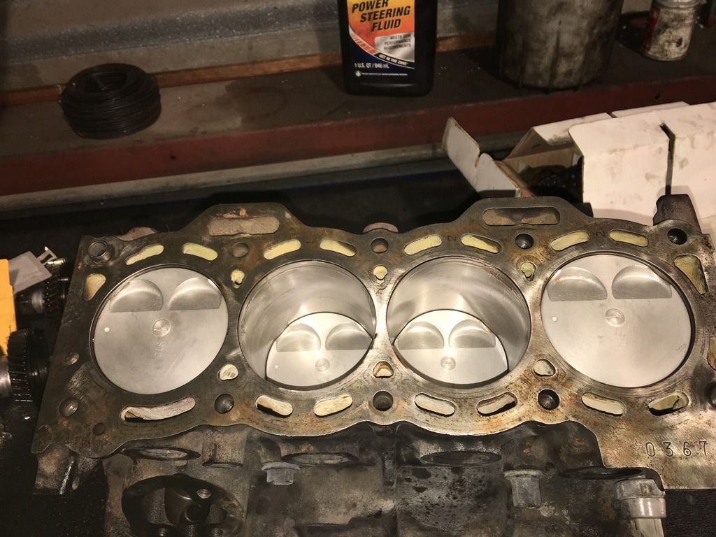

[*] posted on 23-2-2016 at 08:12 PM
4E blew...
Went 5E...
5E blew...
Back to 4E....

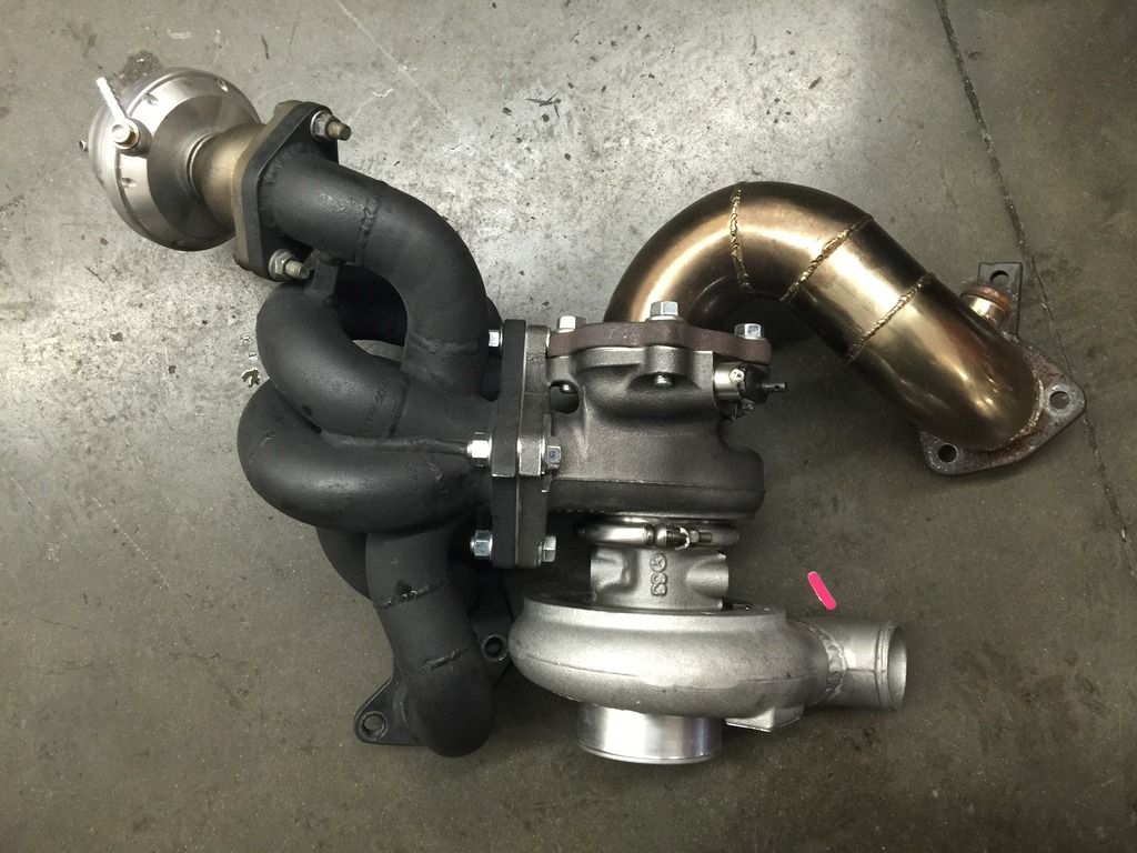

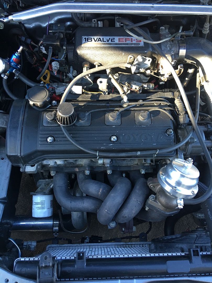

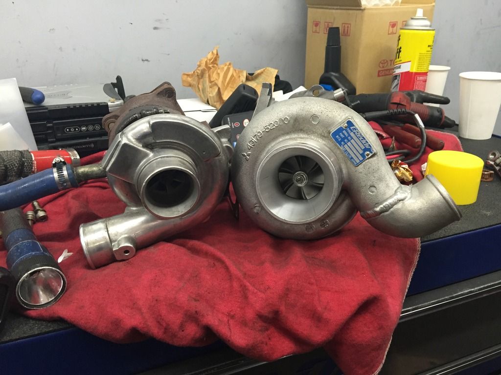

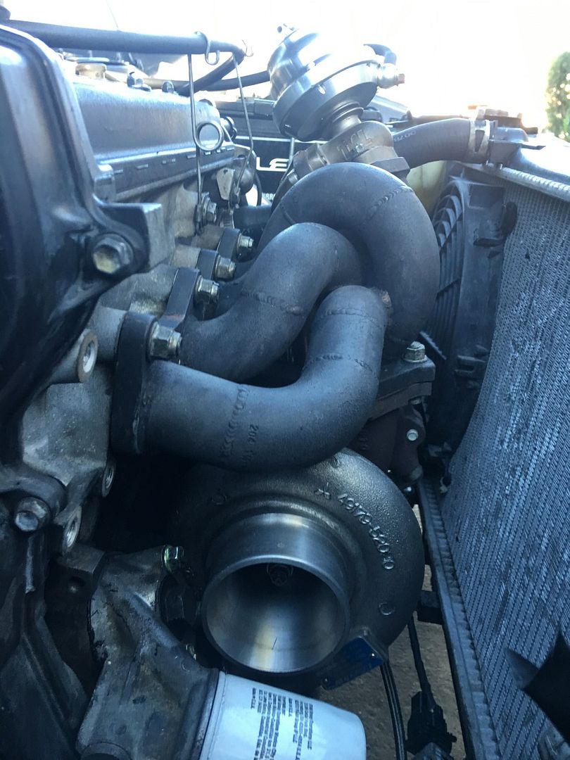

[*] posted on 23-2-2016 at 11:36 PM

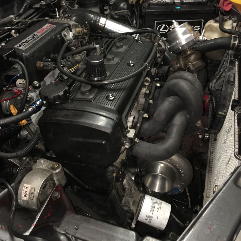

Holy crap that turbo! Very awesome!
How does the intake hook up with the oil filter? I had a hard enough time with stock turbo, that inlet is huge, pipe would run over the filter
[*] posted on 23-2-2016 at 11:58 PM
haven't been able to hook up an intake because of that... turbo isn't even laggy.... :deal:

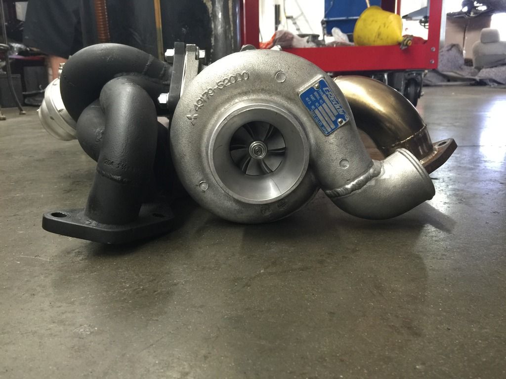

[*] posted on 24-2-2016 at 09:59 AM
Got any new dyno numbers or E.T.'s?
What's the specs on that turbo?
[*] posted on 24-2-2016 at 10:13 PM
not yet, still looking to see about the tuning... debating to ditch the ultimate for something else, seems no one like or knows how to tune it...
The setup is:
4EFTE
Greddy TD05-18G 7cm housing
WEPR Evolution Manifold and DP
Tial Wastegate 38mm 15 PSI Spring
Walbro 190 lp pump
RC 550cc Injectors
eManage Ultimate
FHE ACIS Manifold
AEM wideband <-- Need to get an aeromotive, don't trust this one
[*] posted on 29-2-2016 at 01:02 AM
The setup is:
4EFTE
Walbro 190 lp pump
RC 550cc Injectors
eManage Ultimate
FHE ACIS Manifold
the aem wideband isn't that bad really, and I'm presuming you meant innovative wideband? (not aeromotive)
what boost controller are you using? i know the ultimate can control a boost solenoid and a 4 port would allow you to have better control and run levels drastically higher than the 15psi waste-gate spring
who do you use for tunes in texas?
[*] posted on 2-3-2016 at 06:19 PM
The setup is:
4EFTE
Walbro 190 lp pump
RC 550cc Injectors
eManage Ultimate
FHE ACIS Manifold
yes i meant innovate... sorry was late when i wrote it...
im not running a boost controller at this time.. looking into getting one.
Theres really not many people who tunes emanage here in houston. might have to look outside the city... last time i got it tuned, they did a rough tune, was just controlling AFR
