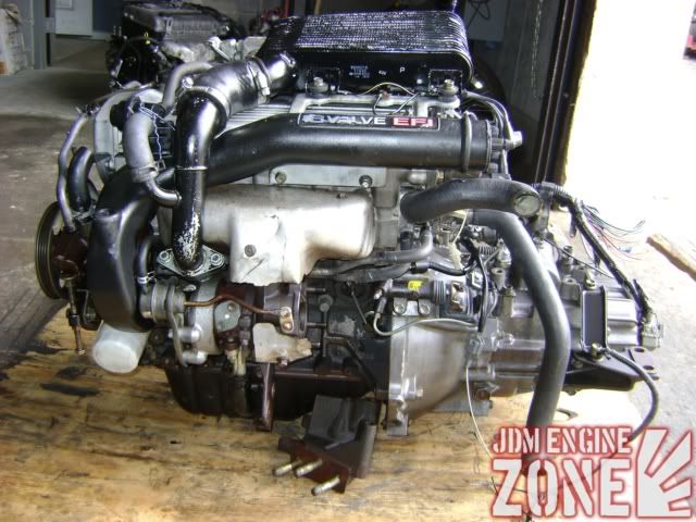

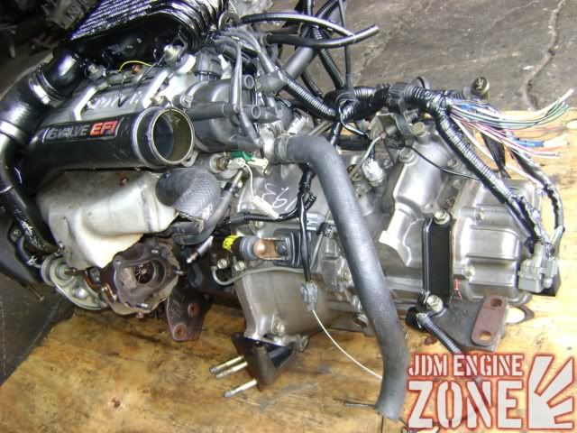

well getting stuff together to swap my 4e that il be getting this wednesday (9/30/09)

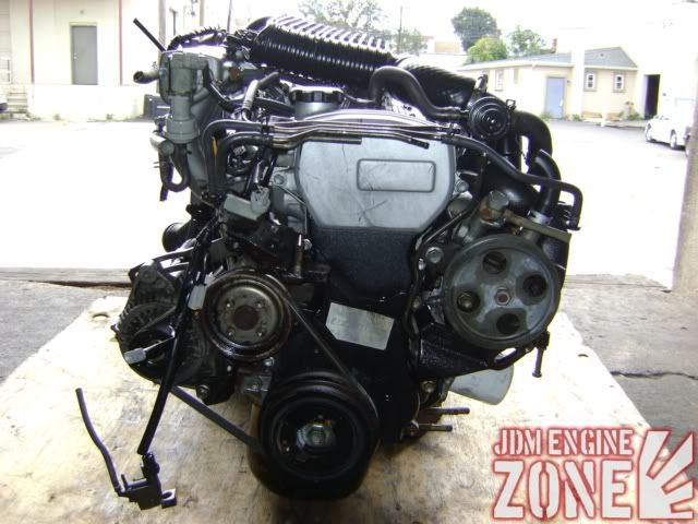

this is the engine i bought:

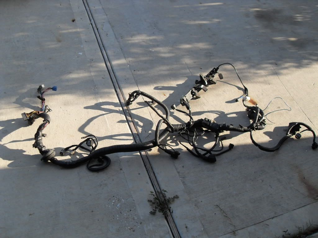

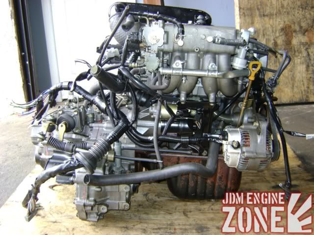

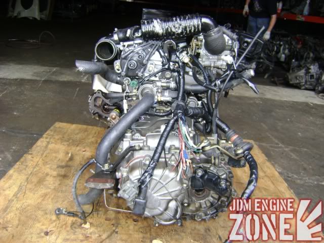

my 5e-4e harness i still have to fix:

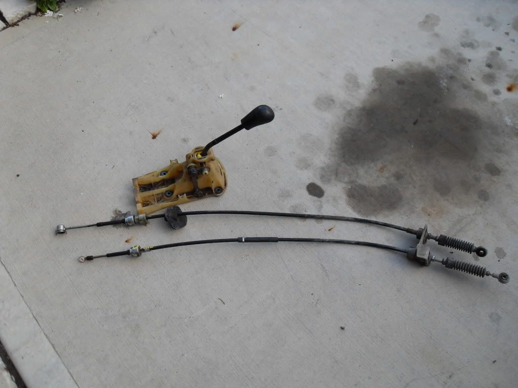

shifter... still need the pedals

[*] posted on 27-9-2009 at 07:18 PM
Just curious, what's to fix about that harness?
I have a DIS Hybrid that needs some TLC, but was known to work once upon a time. In case you need some plugs or something from it.
[*] posted on 27-9-2009 at 07:53 PM
wires not soldered properly, the positive cable is too short and missing a terminal....
its supposely a byp harness, but i think its been messed with...:dunno:
[*] posted on 27-9-2009 at 09:23 PM
I'm hoping my eyes are just failing me but I don't see the coil/ignitor and it looks like the plugs aren't there.
[*] posted on 27-9-2009 at 09:37 PM
Its also missing the factory down pipe/cat...... need one? if so shoot me a U2U I may still have one.
*edit* looks like its missing the TPS sensor too.....
I seen one on ebay today.....
[Edited on 9-28-2009 by kennymp3]
[*] posted on 27-9-2009 at 09:50 PM
did not realize that... i dont see the ignitor!! ahh!!
i knew the harness was cut... i dont need it, i have mine..

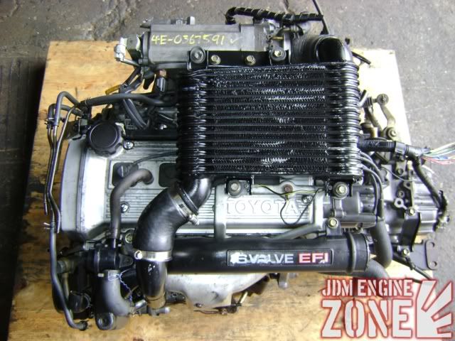

I see the TPS in pic 4.

Originally posted by aroldoarevalodid not realize that... i dont see the ignitor!! ahh!!
The ignitor/coil is different on JDM engines but Trevor or mulberry may have some tricks or gsx-r-1000 is parting a 4e so he may have it.

[*] posted on 27-9-2009 at 10:01 PM
yea it looks broken...:icon help:
but i got the engine for a good price... so i guess its ok... i needed another project...

As for the TPS, yea looks broken but you can get one from toyota with the part number in my 4efte parts list.
[*] posted on 27-9-2009 at 10:23 PM
Here is the the TPS on ebay for around $60 bucks...
http://cgi.ebay.com/Toyota-Starlet-Turbo-EP82-Throttle-Position-Sen...
and here is the ignitor......(kinda spendy)
http://cgi.ebay.com/ebaymotors/Toyota-EP91-Turbo-Starlet-Igniter-4F...
Hope this helps:dunno:
