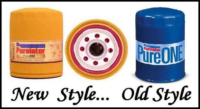

Originally posted by alfradio
I use Purolator's PureONE PL22821
While a considerably larger filter, it fits our engines. I've
used it in TERCEL4's 5EFE since 2003 and am currently
using it in TERCEL1's 4EFTE
alf :waving:
PS: The newer style features a rough canister (sort of like
the Fram filter) making oily hand removal a bit easier.
[Edited on 9/14/2009 by alfradio]
Hey Alf, thanks for the suggestion of running the PL22821. I read this thread and yesterday while at the store put both the stock filter for the tercel and the PL22821 next to each other and WOW they don't look that different from your picture but in real life that thing looks to be 4x the volume. So I said what the hell (i'm sure the 3EE doesn't need it) and threw it on, cleared everything no problem. You're the man :2thumbsup:

Unfortunately, the PL22821 filter (either styles) was discontinued a
couple years ago!
