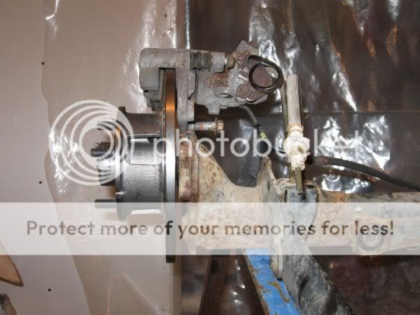

got the axle and the sucker fits,same bearing size inner and outer,4x100 and the wheel studs are the same thread. would have to take the cones out and have them machined in about .25 to make up for the height difference and take the wheel register down a hair to get to the right size. the caliper is just a spare that i threw on for :censored:es and giggles.got another hub thet i want to try but i've got to find the right inner bearing for it.might work out. ron

Whoa!
This is a breakthrough man! What's that off of? and the diameter?

hi there,in its early life....a chevette! i've got other pics of it on the axle on photobucket but all i seem to be able to load is that first pic!

[*] posted on 15-5-2009 at 08:07 PM
sorry its 9.6'' in diameter and .435 thick

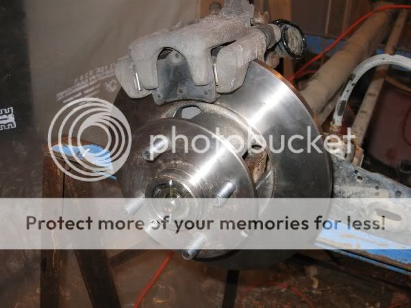

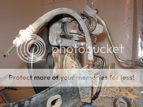

picked up a disk for an 86 jetta(if you cross reference it fits on a pile of different vdubs) and its a much better fit. same outer bearing as the tercel, inner bearing and seal is from a 72 dodge dart 9" front drum. needs a few small mods... 1 turn the outer register down to match the tercel and 2 a small spacer to move the hub out about 4 to 5 mm. the vdubs use screw in bolts to hold the rim on but there's enough meat in the rotor to have the threads drilled out and replaced with lugs. cost so far about $50.00 cdn. going to get a spacer machined this coming week and try a caliper from a ford focus on the rotor(same brake fitting size and easy to find.) are we having fun yet? [img][/img]

sorry i should have mentioned the size 8.9"x.395" and a thank you to dzaster for the pic posting tip....i found out what i was doing wrong
