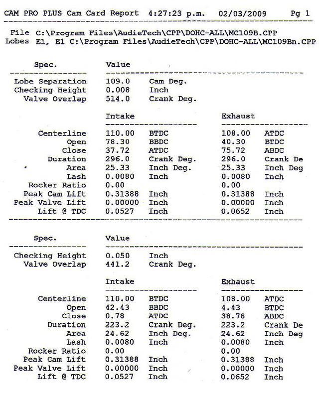

Quote: Originally posted by Wheeler
Here is the specs on my cams I'm getting done in NewZealand at Franklin Cams..........
[Edited on 9/8/2012 by alfradio]
