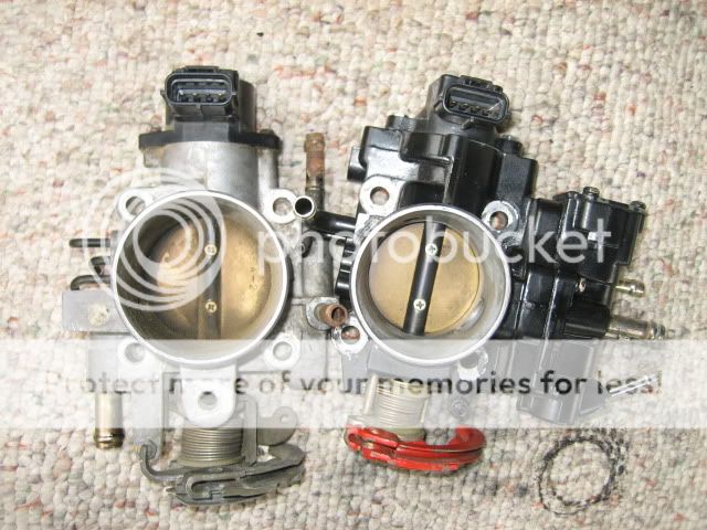

Here's a prospect throttle body, that would require SOME manifold modification, but since I'm using the 4efe manifold and will be looking to modify it soon(extended plenum) anyways, it'll be a good time to fab up a flange to match the TB. Its from a 1991 V6 Camry.
Left: Camry, Right: 1G 5efe
Throttle cable pulley looks to be very similar.

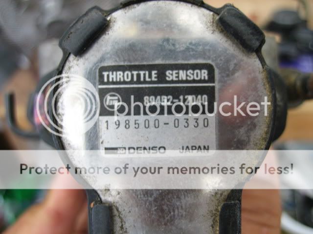

Throttle Position Sensor, exact same one used on the 3ee.
1G Paseo 50mm.

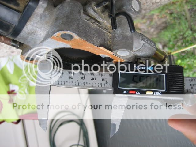

1991 V6 Camry 55mm.
Noted Differences:
- No idle adjustment screw(vacuum altering). There is only the adjustment screw that adjusts the throttle cable pulley.
- Only 2 of the bolt holes to mount the TB match up. The width between holes match fine, but the length between top and lower hole is far off. Best bet would be a new flange.
- Lastly, this TB does not have an IAC valve--not on-board at least. It is just a matter of capping lines.
I know it may not be worth it, I just figure I share it just in case.
