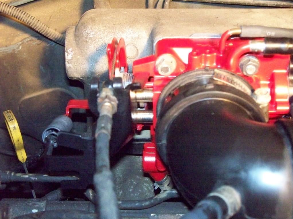

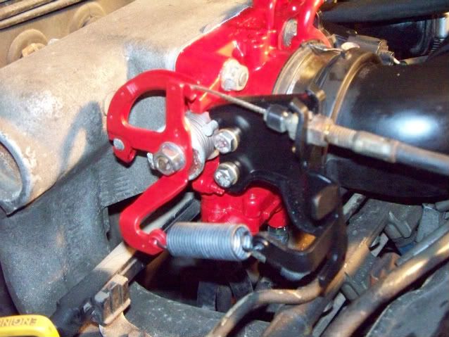

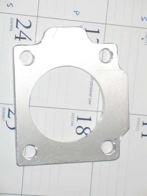

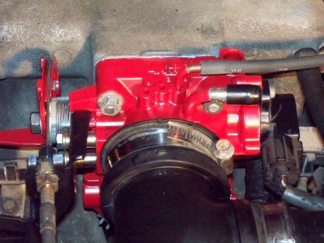

Some of you may have already seen these pics before but I made an aluminum TB spacer last week to compensate for the difference of the 3E intake and the 5E TB. If nothing else it looks a little cleaner.
Here are a couple of pics of the spacer
And here are some with it installed
RDX-JinX

looks awesome ! you gonna paint any other parts? cause that thing must be jumping out as soon as you pop the hood...

It sure does.....I just wanted to try out some ceramic high temp paint to see if it would hold up. Thanks for compliments.

Cool Should see if you can do it with phenolic. That is what Doax's TB insulators are made of. I actually used the one my insulator from my 3ee, but bored it out to match the 5efe TB.

I'm sure I could do it with phenolic but I have aluminum readily available. Did save the program though so may try it in the future.

Big difference - no, but does help the engine rev a little quicker. There is a noticeable difference between the 3E and 5E TB while driving.
The reason for the TB spacer is that there is a difference between the mounting flanges. If you were to bolt up a 5E TB to the 3E manifold there would be a open space on the side where air would get through causeing you car to not run well. Basically a very big vacume leak. Most people use JB weld or silicone to block the holes including myself. It works but isn't pretty.
