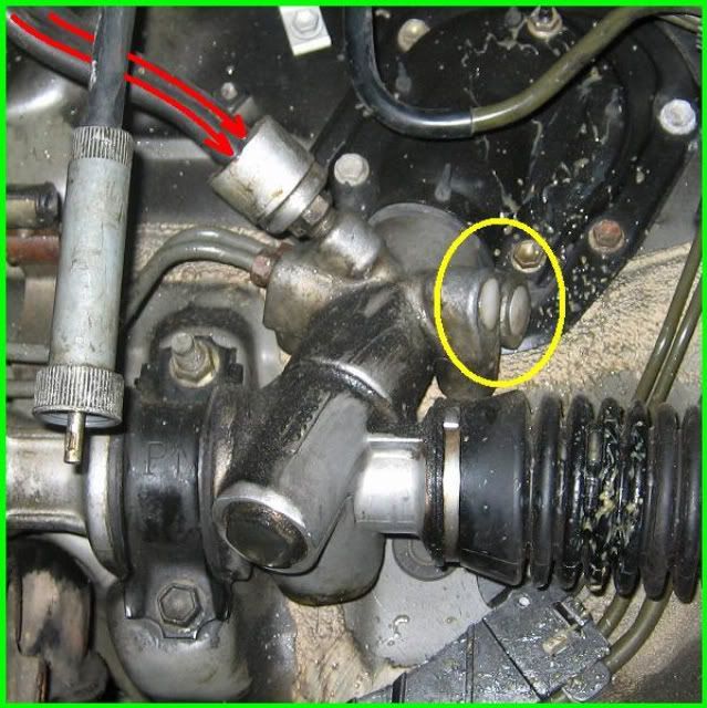

What I did when I removed the entire P/S from my '97 Tercel
was to turn the wheel, lock to lock several times and then cap
off the holes on the rack where the hoses connected (so no
debris would get in there)
...and i"ve never had any problem... steering has always felt
smooth.
Just re-read your post... I'm assuming you removed the pump
and the hoses which went back to the steering rack, right?

dont forget, the shaft of the steering column that attaches to the steering rack is shorter on ps models than non ps so...you'll either have to change the column itself or, extend your current one by welding a piece on to it.:deal:
also, the plastic piece that covers where the shaft goes through the firewall is different between ps and non ps models:deal:

I was thinking of doing it more like Alf's way. Is it okay to just remove extra hardware and cap off/
[*] posted on 4-7-2008 at 04:31 PM
nothing wrong with that way.
it works and, is a lot easier.:deal:
